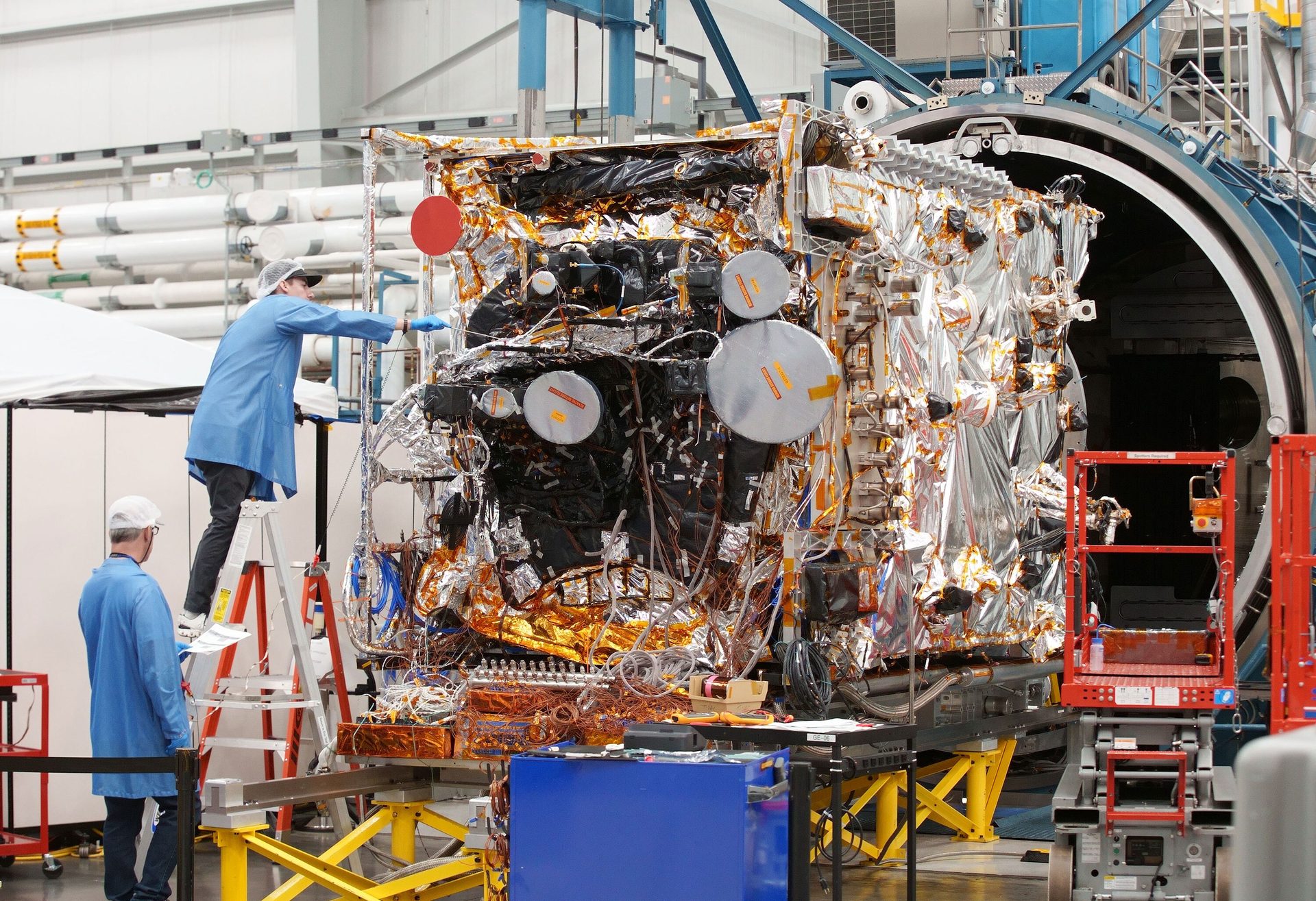

Northrop Grumman assemblers build a variety of complex satellites. Photo courtesy Northrop Grumman
