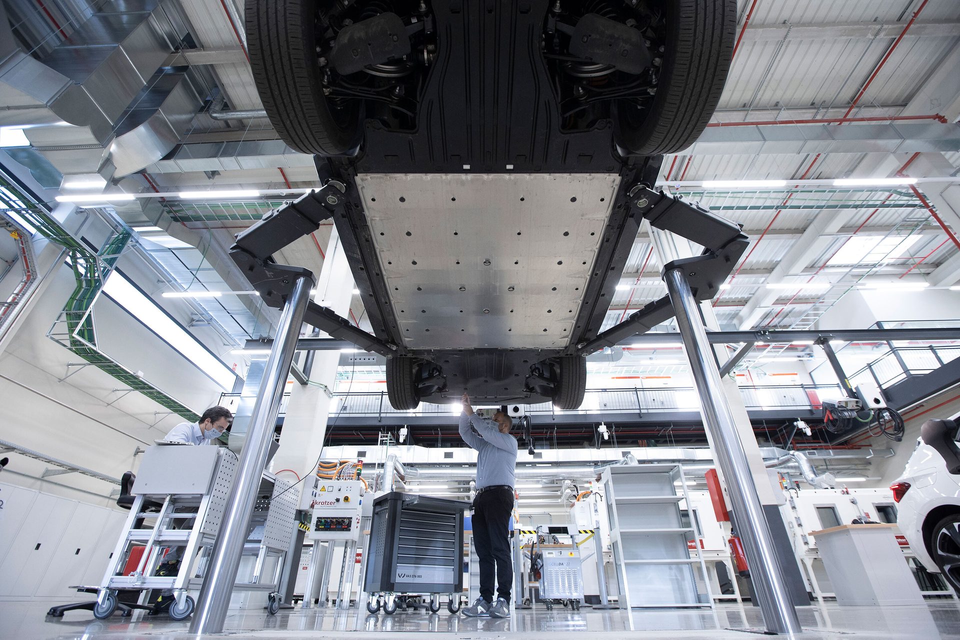

Worker inspects the battery pack of an electric car elevated on a workshop lift.
Many EVs use a skateboard chassis that mounts the battery low in the floor, improving rigidity, lowering the center of gravity and enabling sportier handling. Photo courtesy SEAT
Skateboards Drive EVs
Skateboard chassis are at the heart of most modern electric vehicles. This design places large battery packs flat along the floor of the vehicle, sandwiched inside a rigid protective tray.
Mounting the battery low and wide does two crucial things: it keeps the center of gravity stable, which improves handling and reduces rollover risk, and it frees up space inside the cabin because bulky engine components are no longer needed up front.

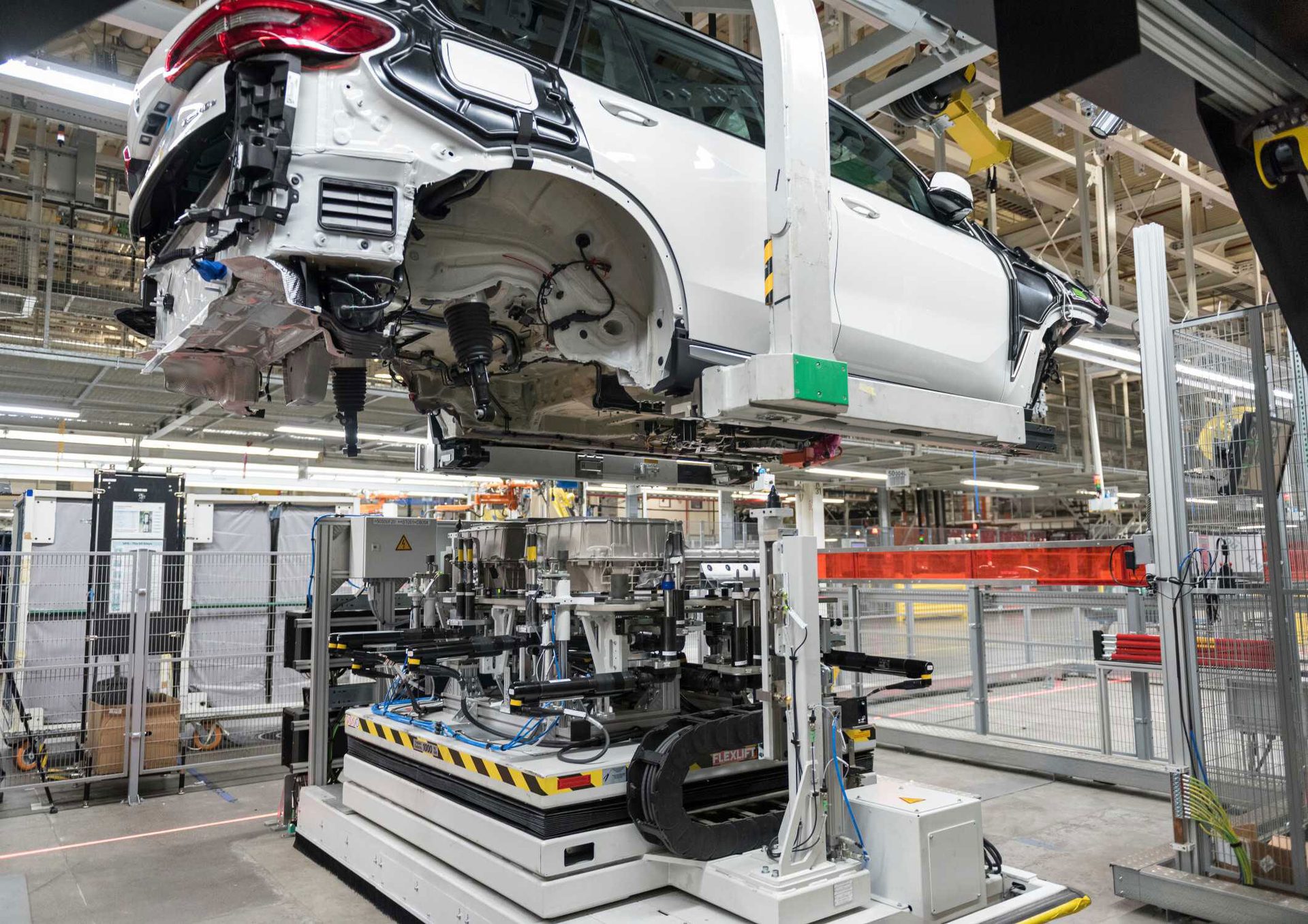

Partially assembled white SUV body suspended above an automated assembly machine in a factory.
Neue Klasse EVs integrate a high-voltage battery directly into the chassis as a structural element, which reduces weight while increasing rigidity and safety. Photo courtesy BMW AG
BMW Takes a New Approach
Engineers at BMW have developed next-generation EVs that feature a new type of chassis. The first vehicles built on the Neue Klasse platform, such as the iX3 crossover, are being produced at the automaker’s state-of-the-art assembly plant in Debrecen, Hungary.
The chassis incorporates integrated crash structures and suspension systems optimized for weight and safety, while reinforced side sills further improve passive safety—a concept that enables scalability across other models and derivatives.
The Neue Klasse platform features a “pack-to-open-body” principle, which integrates the high-voltage battery as a structural element of the chassis.
“This approach reduces overall weight and enhances rigidity,” says Moritz Schmerbeck, a spokesperson for the BMW Group production network. “Additionally, we achieved a 30 percent weight reduction in the wiring harness and shortened its length by 600 meters compared to previous generations.”
The entire chassis is produced in-house, starting with large aluminum and steel sheets that are processed into individual parts and subsequently assembled into the complete chassis.
“Assembly is fully automated and digitalized, featuring live vehicle tracking and AI-driven quality checks,” says Schmerbeck.

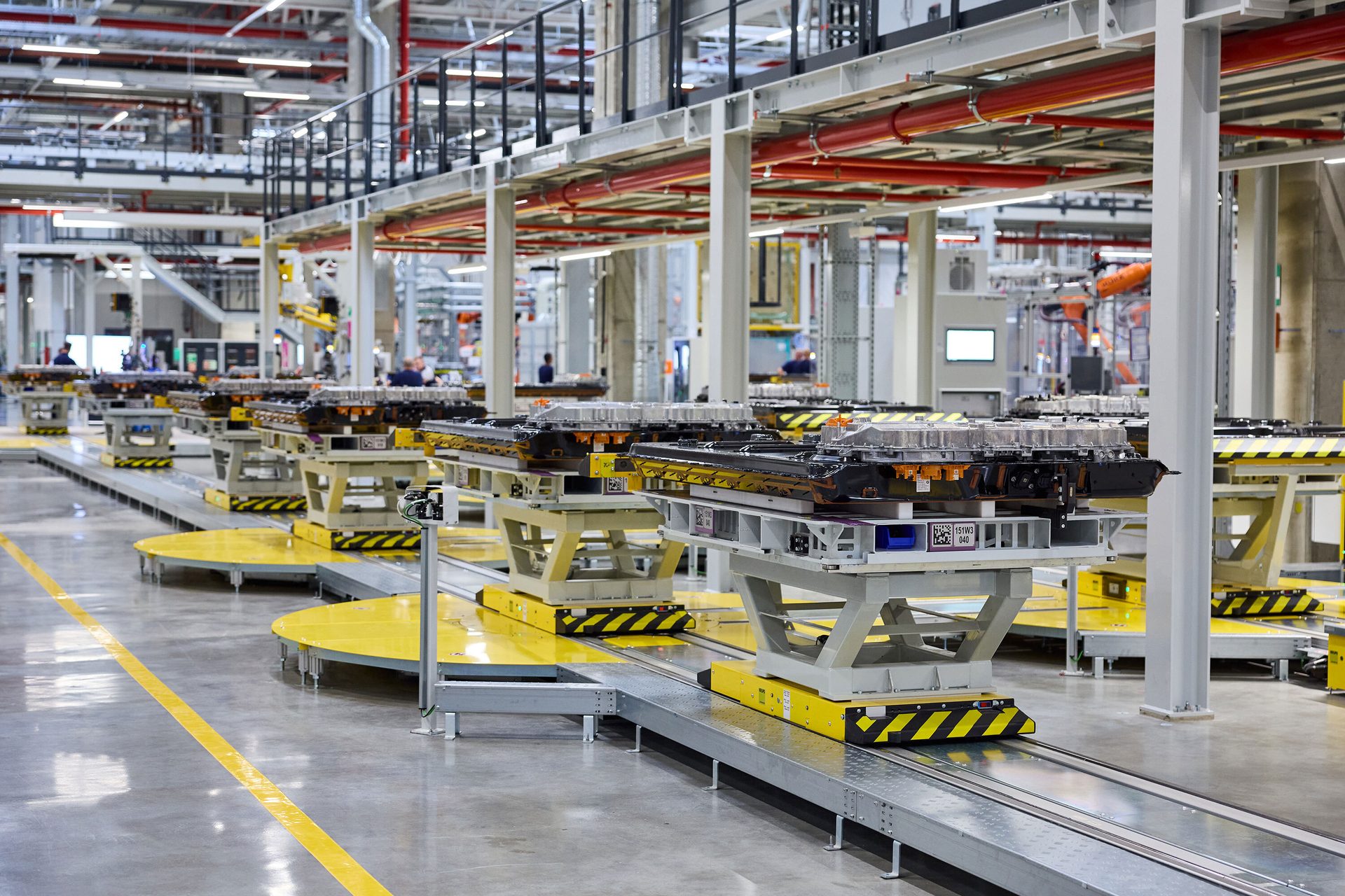

EV battery packs on an automated assembly line.
Because battery cells are integrated directly into the pack of BMW’s Gen6 design, it eliminates the need for individual modules. Photo courtesy BMW AG
