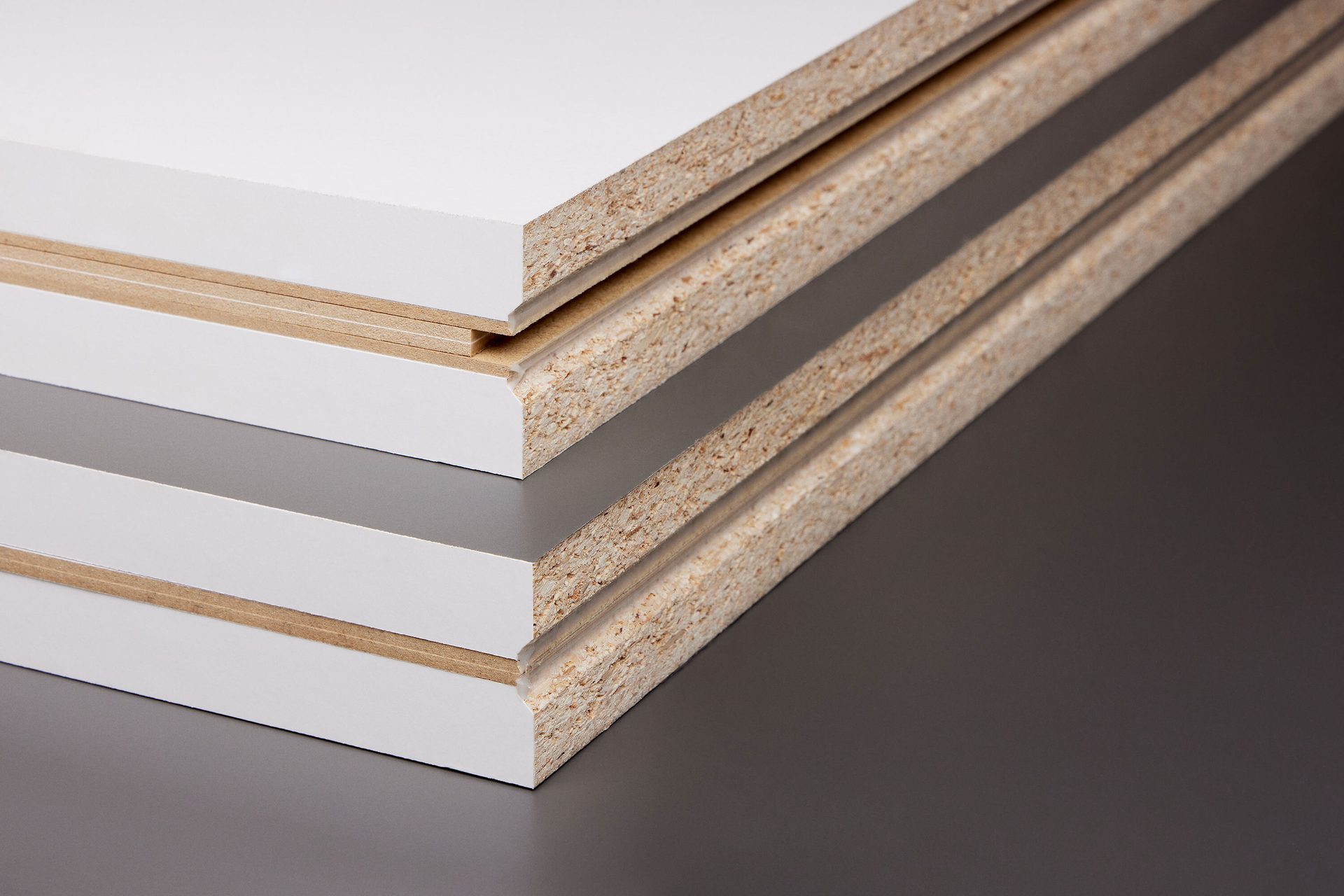

One of the company’s newest products is the Pax 2.0 wardrobe, a foldable wall cabinet designed for faster, easier assembly, requiring less space and no heavy lifting. It features a one-piece, pre-glued back and side panel that unfold like a book. “Wedge dowel” joints snap together without the need for screws, cutting assembly time in half.
The vision behind Pax 2.0 is a wardrobe that can be assembled by one person without tools. Flat-pack furniture with a folding back panel has been around for some time. IKEA took the concept a step further by gluing the back panel directly to the side panels. The finished piece of furniture is then unfolded like an accordion and set up. The advantage of this design is that the back panel is attached to the side panels from behind, so no space is lost in the depth of the wardrobe.

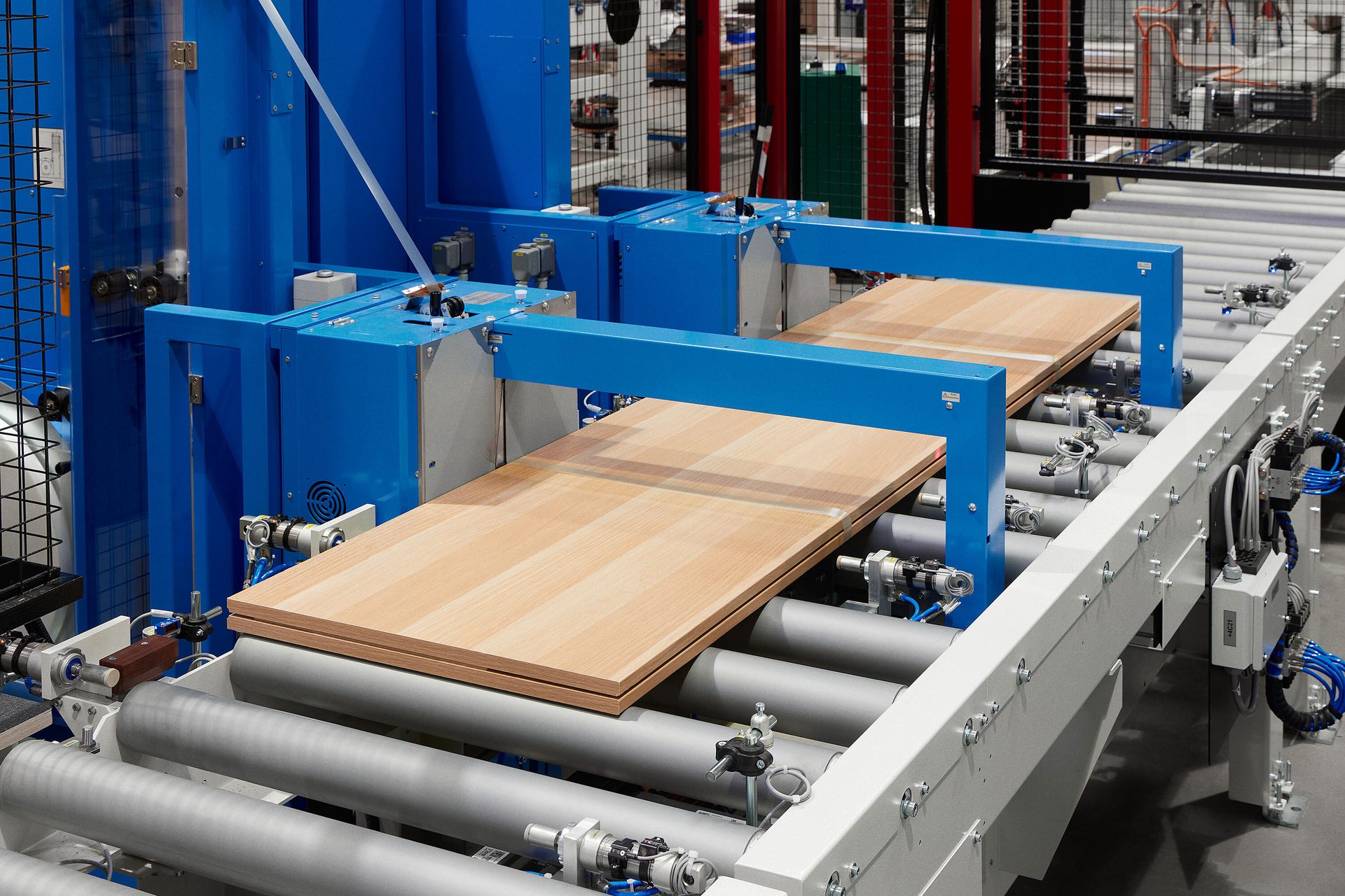

Lehbrink developed a continuous-flow production system specifically for the Pax 2.0 product. The system aligns the side panels and back panel with millimeter precision—the biggest challenge of the project. Everything else is a sequence of proven processes: cutting to the correct width, bonding and cooling.

The system aligns the side panels and back panel with millimeter precision. Photo courtesy Robatech
