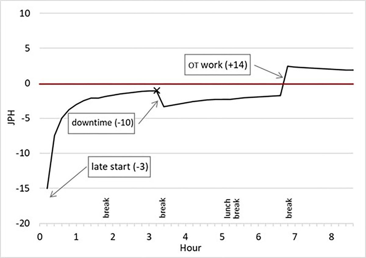

JPH line graph over 8 hours, showing impacts of late start, downtime, and overtime work. courtesy Eastern Michigan University
Throughput rate—often expressed as jobs per hour (JPH)—captures real-time variation in production. In this example, three events are evident: a late start (-3 units), a breakdown (-10 units), and overtime recovery (+14 units). Photo courtesy Eastern Michigan University

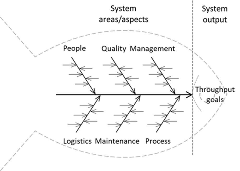

A fishbone diagram illustrating how system aspects (e.g., People, Quality Management) affect throughput goals.
Throughput performance is affected by multiple operational factors. Photo courtesy Eastern Michigan University
Throughput rate—often expressed as jobs per hour (JPH) or units per time unit—captures real-time variation. Unlike cumulative counts, rate tracking reveals performance fluctuations during a shift.
Figure 1 illustrates an example of a throughput rate deviation chart over a shift. In the example, three events are evident: a late start (-3 units), a breakdown (-10 units), and overtime recovery (+14 units). Overall, the shift achieved its target; however, it did so at the expense of significant overtime costs.
Action: Use production counts for overall results and JPH deviation charts for performance diagnostics. When inline inspection is available, exclude defective units from both metrics.

Throughput performance is affected by multiple operational factors. Effective measurement requires structured key performance indicator (KPI) frameworks spanning six critical areas rather than two or three isolated metrics.
To comprehensively capture multiple dimensions of production performance, various metrics or KPIs are typically needed. Table 2 shows an example of KPIs across six areas for a high-volume production environment.

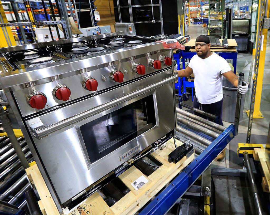

Man in a Wolf Appliance factory setting inspecting a shiny stainless steel Wolf range and oven on a conveyor.
Data integrity is critical to the success of any effort to implement key performance metrics. Stakeholders will only act on numbers they trust. Photo courtesy Wolf Appliance Inc.

     Data integrity: Stakeholders act only on numbers they trust; prioritize data validation first.
