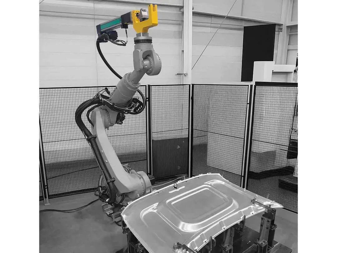

The staking tongs can be mounted to a robot for automated assembly lines. Photo courtesy Tox Pressotechnik

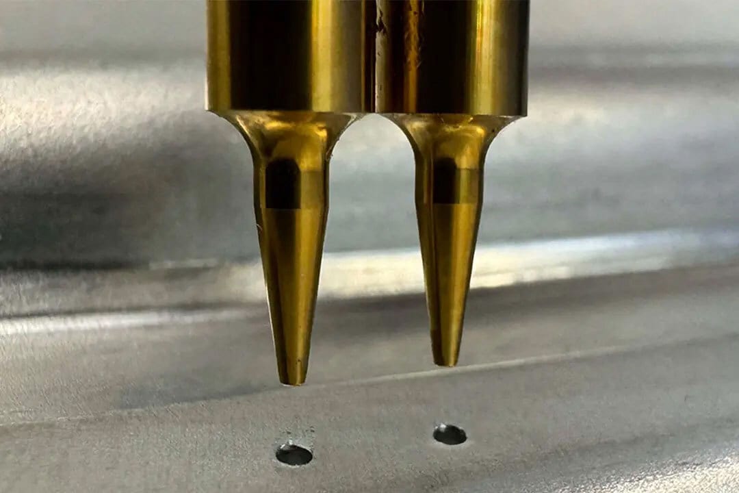

A new sheet-metal joining process developed by Tox Pressotechnik promises to solve those problems. The company’s SeamStake cold-joining process reliably secures sheet metal components and prevents displacement in the planar direction. Secure fixation is achieved through precisely formed positive locks.
Two golden probes hovering above a metallic surface with two small holes, likely for spot welding or testing.

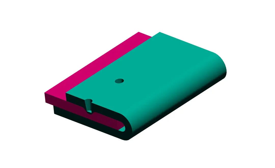

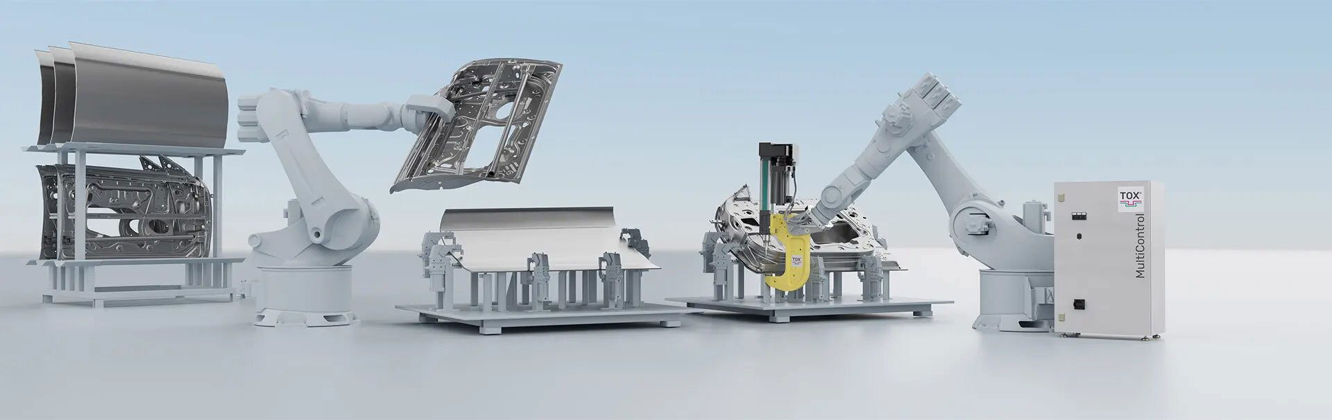

In the process, a hardened pointed tool is pressed into the top sheet. Metal from the top sheet is thus forced into the bottom sheet, creating a lock. Photo courtesy Tox Pressotechnik
3D CAD model of two layered components, one magenta and one teal with a rounded top and holes.
The SeamStake process does not adversely affect the surface of the component opposite the forming tool.Photo courtesy Tox Pressotechnik
In the process, a hardened pointed tool is pressed into the top sheet. Metal from the top sheet is thus forced into the bottom sheet, creating a lock. Because the process requires precise control over the force, displacement and speed of the tool, a servo press is required. Unlike other sheet-metal clinching methods, the SeamStake process does not require special tooling on the opposite side of the joint. In addition, it does not adversely affect the surface of the component opposite the forming tool. There’s no need to remove weld spatter after joining.
The process can be used on a variety of materials and applications. A minimal amount of space is required around the parts to complete the process.
