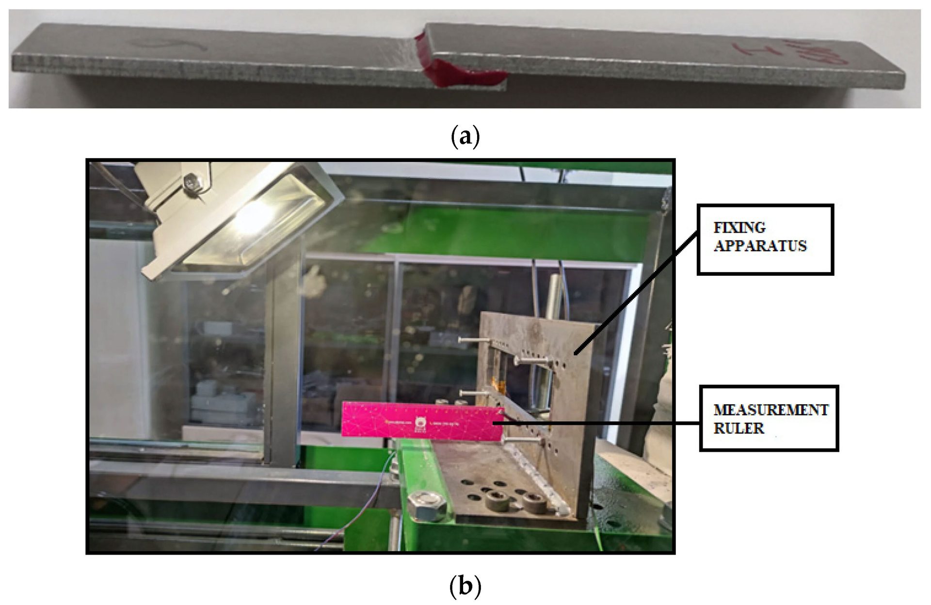

Experimental setup: (a) metal joint with red adhesive, (b) fixing apparatus with ruler.
These images show the bonded test coupons (a) and the apparatus (b) in which the specimens are fixed before the test. Source: Ankara Yildirim Beyazit University

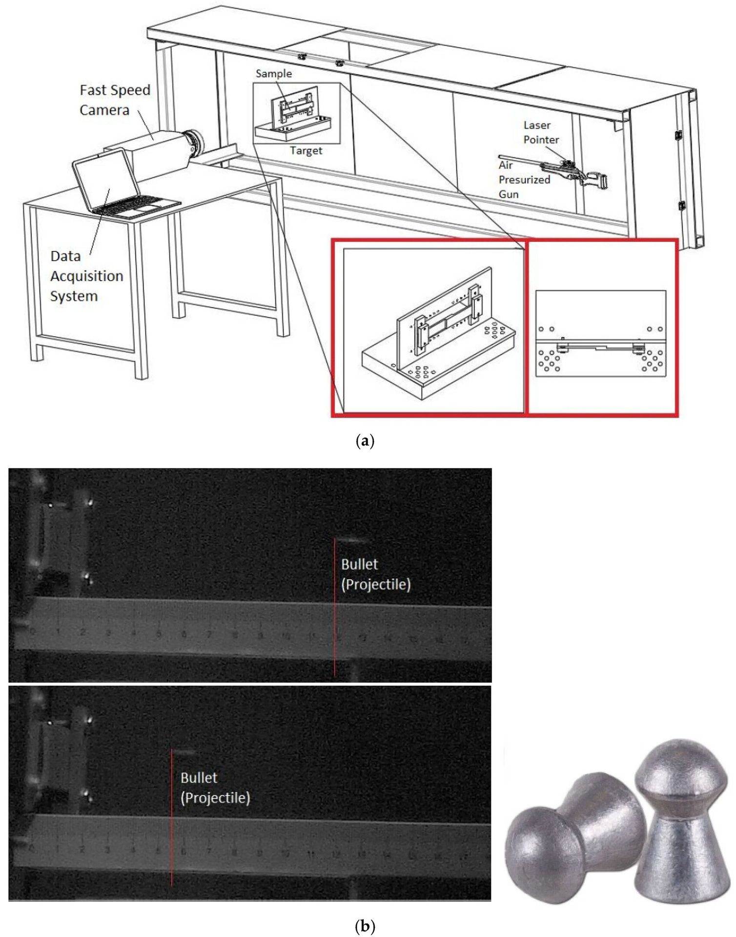

Diagram of a high-speed impact test setup with an air gun, camera, target, projectile image, and lead pellets.
The test setup (a) consisted of a pressurized air gun, a high-speed imaging system, data acquisition equipment, and a custom clamping fixture to securely hold the test specimens. A high-speed camera captured the bullet in flight (b). Source: Ankara Yildirim Beyazit University

The test setup consisted of a pressurized air gun, a high-speed imaging system, data acquisition equipment, and a custom clamping fixture to securely hold the test specimens. Measuring 5.5 millimeters in diameter, the projectiles were round-nosed lead pellets, each weighing 1.25 grams. The distance from the projectile to the target was 210 centimeters.

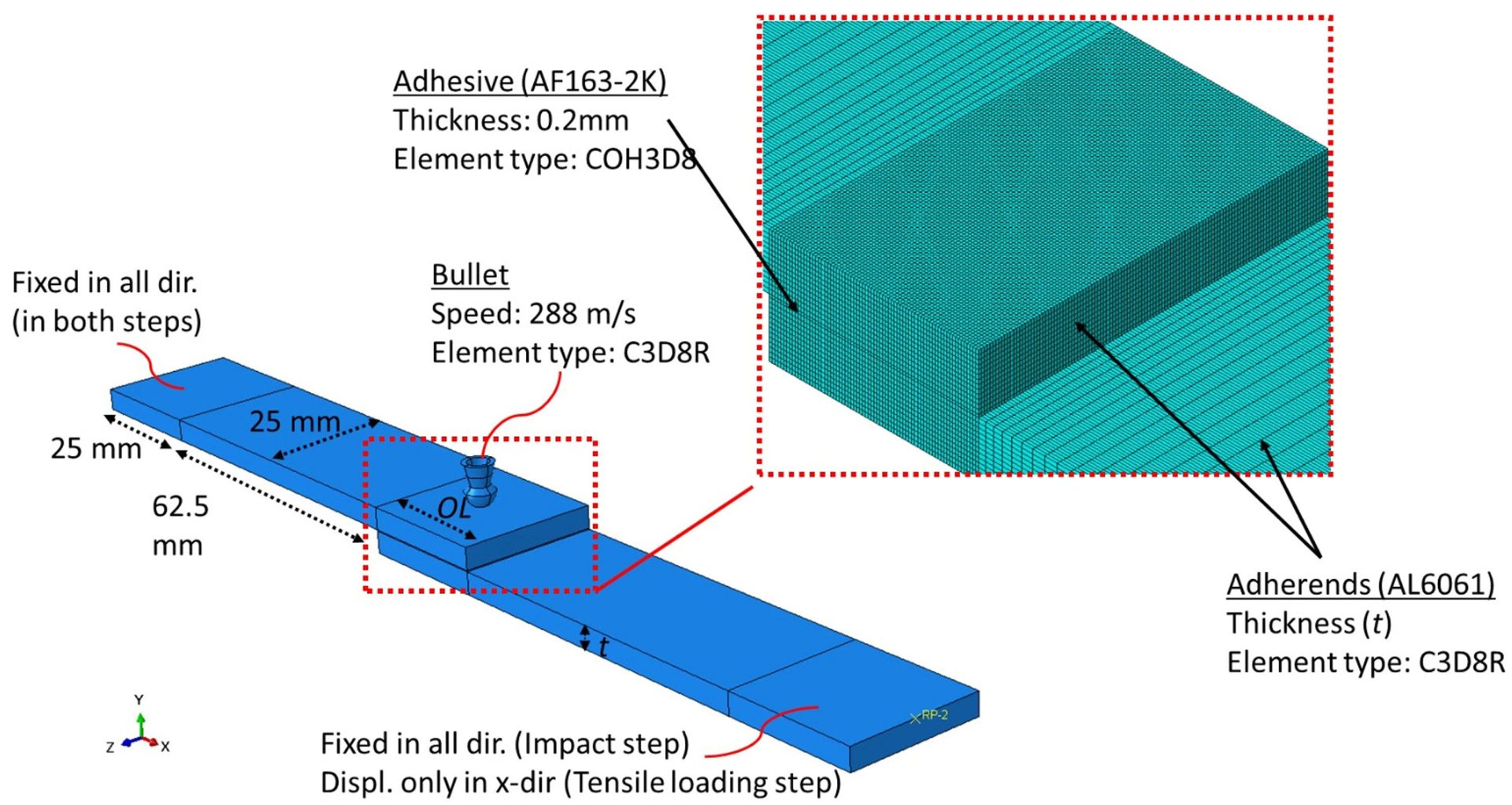

FEA model of bullet impacting an adhesive joint, showing components, dimensions, and mesh detail.
This illustration shows the 3D finite element model of the lap joint subjected to a high-speed impact followed by quasi-static tensile loading. Source: Ankara Yildirim Beyazit University
Numerical Modeling
Numerical analyses were conducted using ABAQUS to investigate the dynamic response of SLJs under impact conditions. We developed a detailed 3D FE model. The aluminum coupons were represented by eight-node linear brick elements incorporating reduced integration and hourglass control to improve both computational efficiency and numerical stability.
To ensure accurate prediction of stress concentration and progressive damage, a highly refined mesh was applied in the overlap zone, featuring element dimensions of roughly 150 by 150 by 150 microns for the adherends and slightly coarser elements of 150 by 200 by 150 microns for the adhesive layer, resulting in approximately 16,666 elements within the adhesive for an overlap length of 15 millimeters.

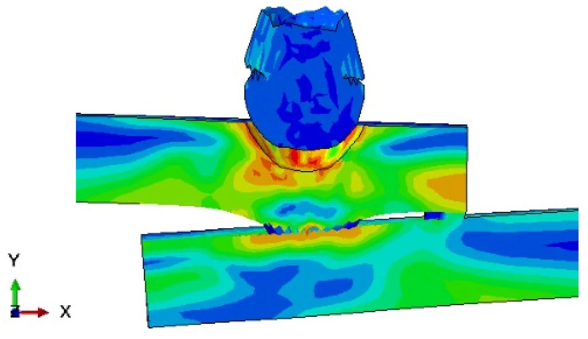

FEA simulation: blue impactor striking layered plates, displaying stress distribution and deformation.
This simulation image shows the deformed shape of the SLJ six microseconds after the bullet impact. Source: Ankara Yildirim Beyazit University
Beyond the overlap region, a graded mesh with a bias ratio of 2 along the joint length was employed for the coupons. Mesh convergence was validated by comparing the predicted force-displacement curves, which exhibited deviations of less than 5 percent relative to results obtained from finer mesh. This mesh configuration was also examined for the damaged area after the impact test, and the difference compared to a finer mesh was found to be less than 3 per-cent.
The adhesive layer—generated by separating the overlap section from the ad-herends—was simulated using linear cohesive elements.
The simulation procedure was carried out in two consecutive stages. In the first stage, the SLJ was impacted by a deformable projectile modeled with solid el-ements and assigned an initial velocity of 288 m/s.

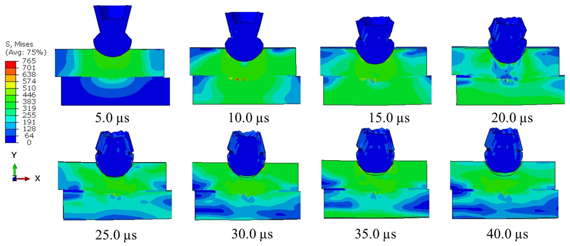

Time-series of Von Mises stress during indenter impact on stacked plates, from 5.0 to 40.0 µs.
This simulation image shows the change in the distributions of von Mises stress on the bonded joint 4 microseconds after high-speed impact with the bullet. Source: Ankara Yildirim Beyazit University

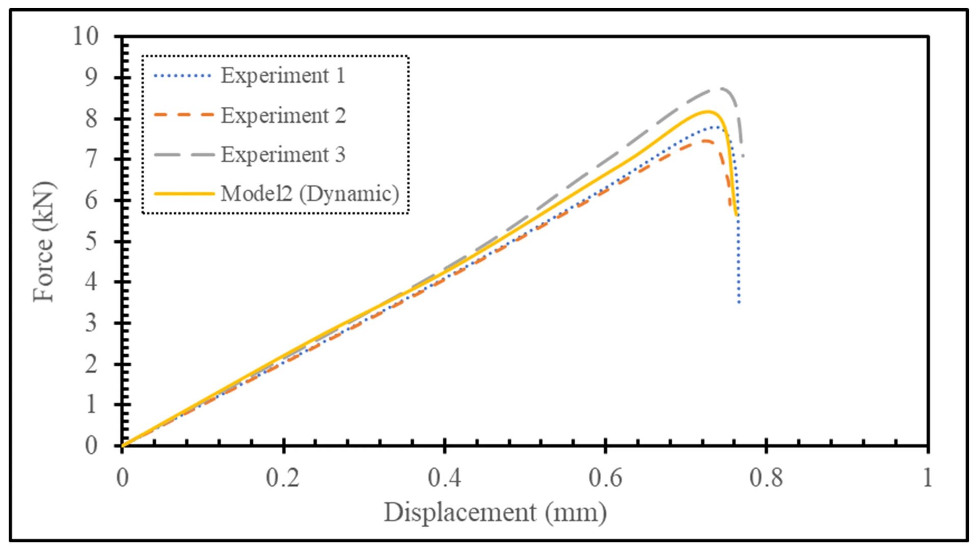

Force-displacement graph of 3 experiments and 1 dynamic model.
This graph shows the force-displacement curves from tensile tests obtained ex-perimentally (experiments 1–3) and from simulations. Our finite element mod-el was very close to actual results. Source: Ankara Yildirim Beyazit University

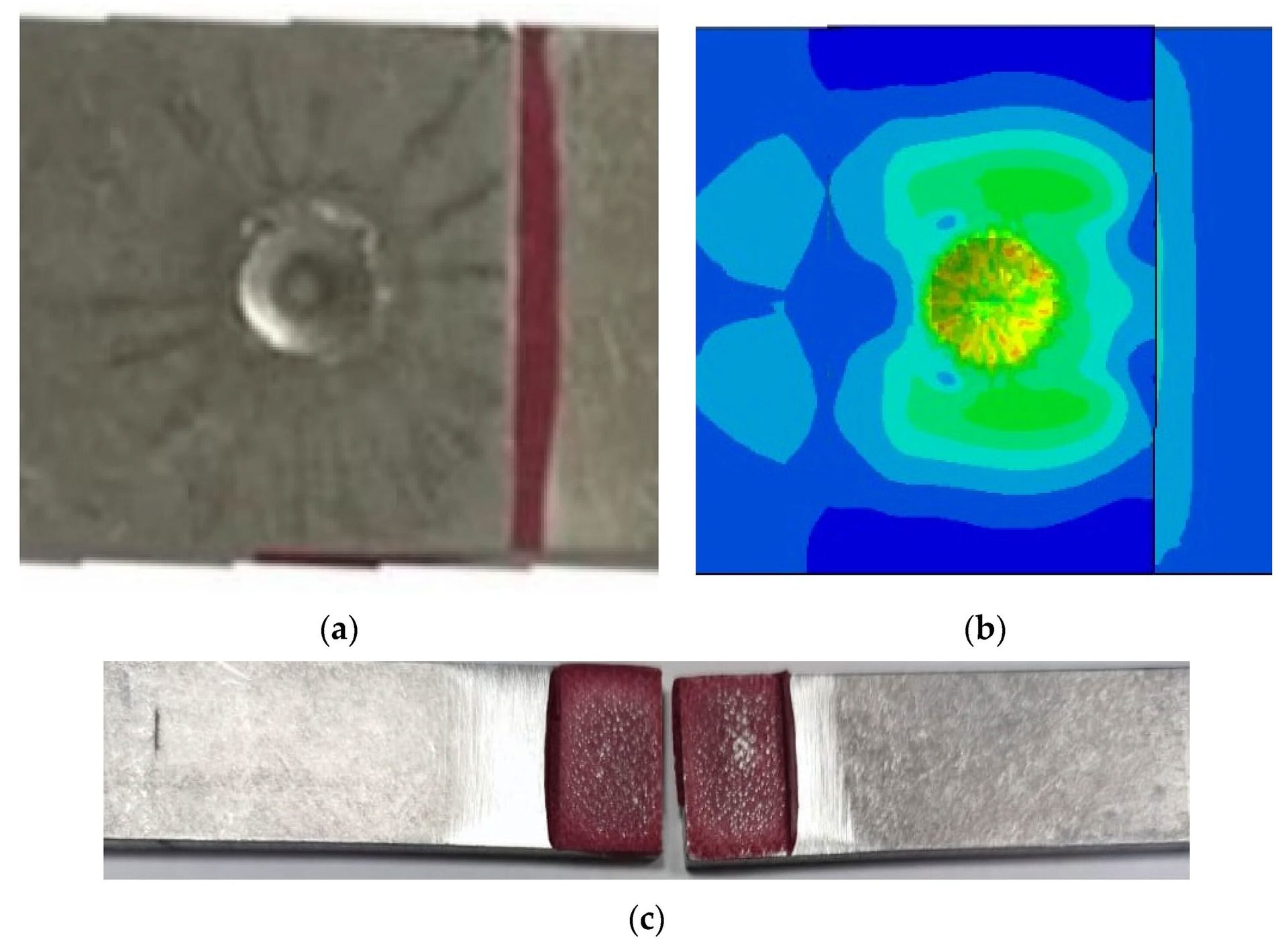

Indentation, stress plot, and fractured surfaces of a material test.
These images show the top view of the bonded joint after impact with the bullet. The left image (a) shows the actual joint; the right image (b) shows the numerical model. The bottom image (c) shows the deformation of the joint after tensile testing. Source: Ankara Yildirim Beyazit University

In the simulation, the bullet penetrates the joint within the first 15 to 20 microseconds and then rebounds after undergoing severe deformation. Notably, the force-displacement curves from post-impact tensile tests, obtained both experimentally and through simulation, showed strong agreement.

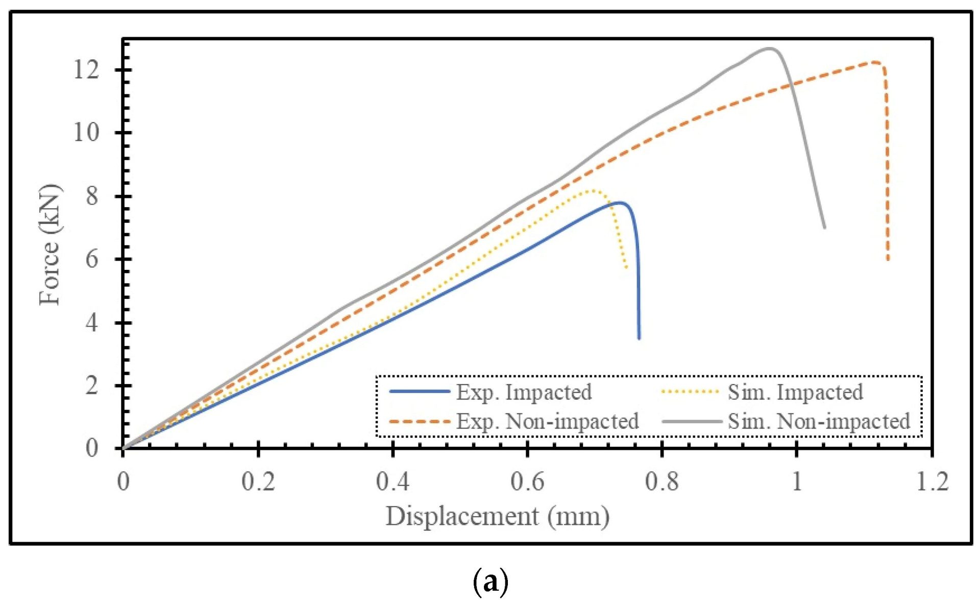

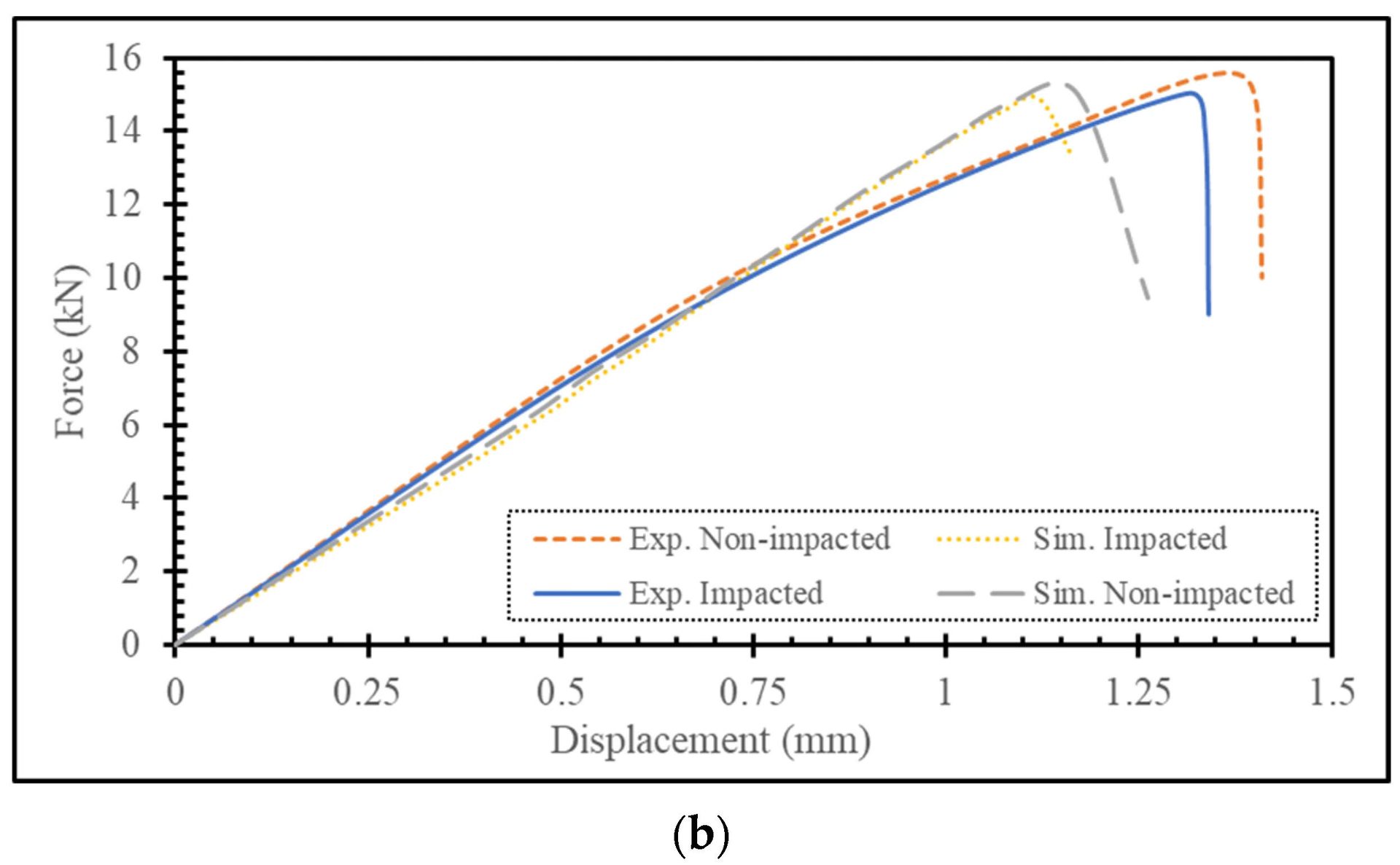

Force-displacement graph comparing experimental and simulated data for impacted and non-impacted states.
These load-displacement curves show the difference in tensile strength between the bonded joint with a 15-millimeter overlap (a) and the joint with a 25-millimeter overlap (b). Not surprisingly, the latter was stronger. Source: Ankara Yildirim Beyazit University
Force-displacement curves comparing impacted and non-impacted conditions, experimental and simulated.
Influence of Overlap and Substrate Thickness
Our experimental results indicated that the post-impact tensile strength of the assembly with a 15-millimeter overlap exhibited significant degradation, with its load-bearing capacity decreasing by approximately 33 percent. In contrast, the assembly with a 25-millimeter overlap largely maintained its post-impact structural integrity. These findings suggest that increased overlap length miti-gates the adverse mechanical effects of impact loading on the joint’s tensile performance.

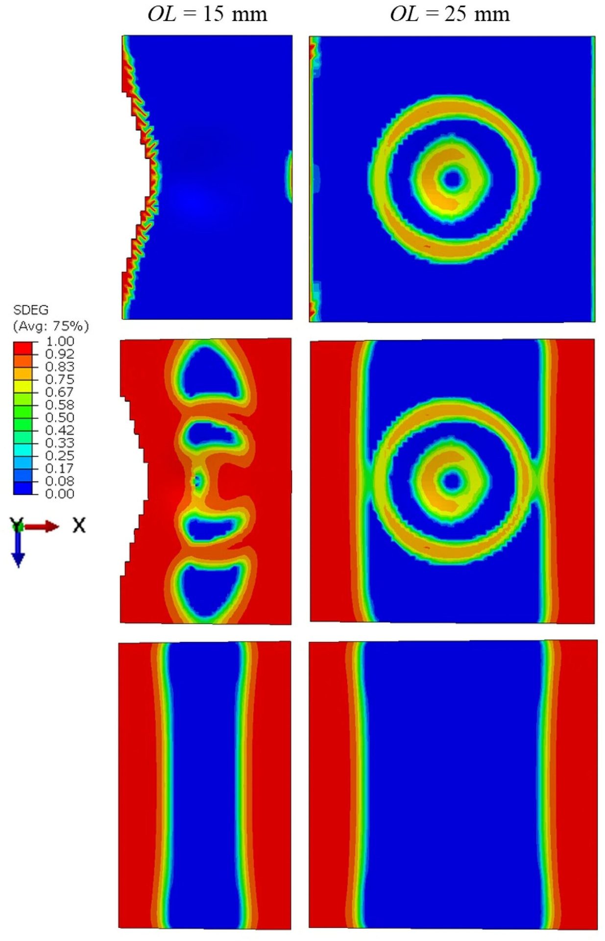

SDEG contour plots comparing damage patterns for 15mm and 25mm overlap lengths.
These images show damage distribution on the adhesive layer for the specimens immediately after impact (top), just before failure during tensile testing (middle), and for the control specimens just before failure during tensile testing (bottom). Source: Ankara Yildirim Beyazit University
The damage distribution within the adhesive layer during tensile testing showed a significant contrast between the impacted and non-impacted assemblies. In the non-impacted specimens, damage gradually developed from the central region toward the ends of the adhesive layer, exhibiting a relatively uniform progression along the width of the joint. However, in the impacted samples, the presence of pre-existing damage localized at the center—resulting from the projectile strike—led to a more heterogeneous damage pattern, with prominent damage concentrated in both the central and end regions of the adhesive layer.
The FE analysis of damage progression in the adhesive layer indicated that bullet impact caused damage at the ends for shorter overlap lengths, while for longer overlap lengths, damage was confined to the center. Since the ends of the overlap length bore more tensile loading compared to the central region, joints with an overlap length of 15 millimeters experienced mechanical degradation, whereas those with a 25-millimeter overlap length did not.
