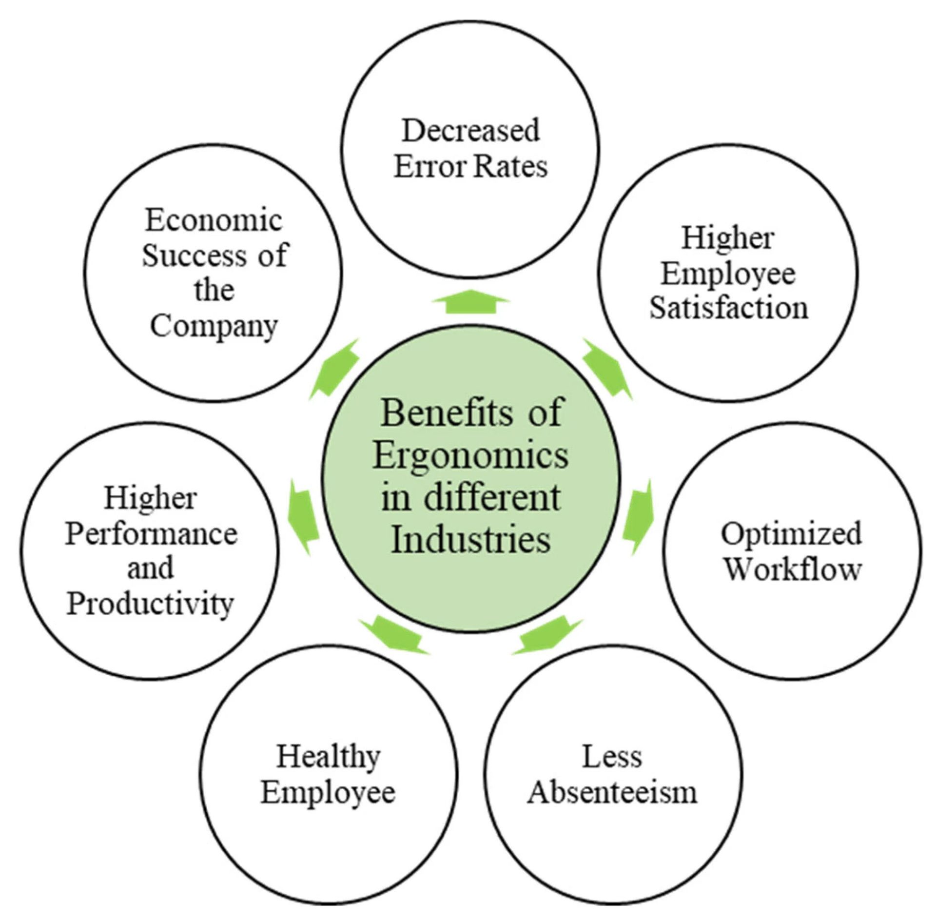

Diagram: Benefits of ergonomics including economic gains, employee welfare, optimized operations, and fewer errors.
Good ergonomics provides myriad benefits, regardless of industry. Source: University of Johannesburg

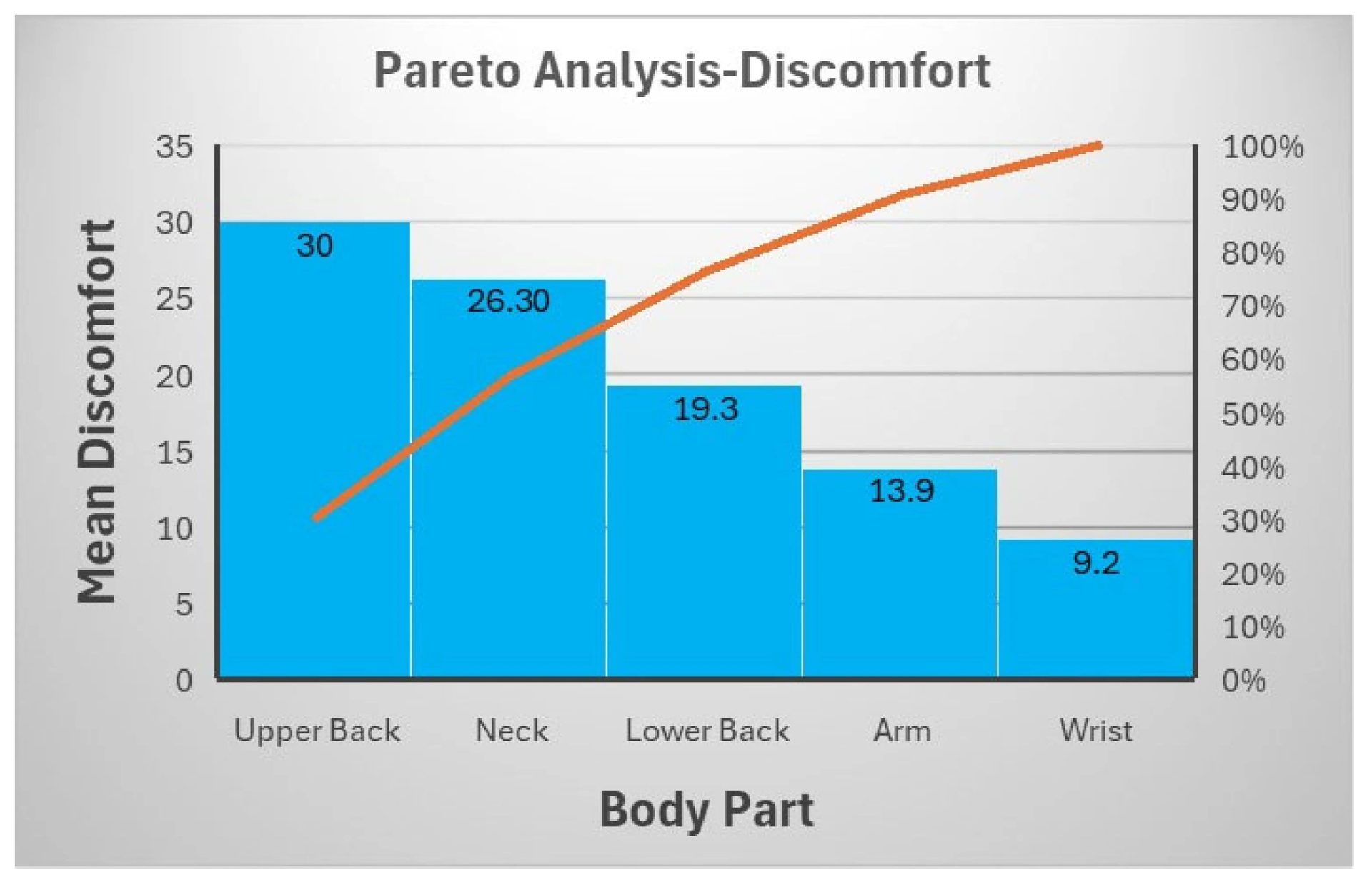

We then conducted a Pareto analysis to rank the body parts receiving maximum discomfort. The operators reported high levels of discomfort in various body parts, such as the upper back, neck, lower back, arms and wrists.

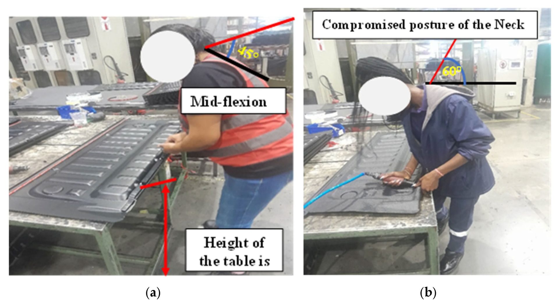

Two workers demonstrate poor ergonomic postures with neck/back flexion at 45° and 60° angles.
The researchers observed workers performing various assembly tasks. (a) An employee is aligning a clip into the hand tool bracket, inserting into the lower bracket, pushing down into position, and repeating four times to complete the right and left brackets. They place the lower bracket into the table, making sure the edges align with the tailgate. They align bolts with four holes and loosely fasten them. In the next image (b), the worker uses a T25 spline to drill and ensure the bolts are not loosely fastened to the tailgate. Source: University of Johannesburg

BPSS data revealed 32 workers who felt “discomfort” in upper back, shoulders, lower back, arms, wrists and neck. An additional 22 workers felt “extreme discomfort” in those areas.
Weighting these scores enabled us to prioritize areas for ergonomic improvements, such as improved workstation design, training on better lifting techniques, and additional support equipment.
A Pareto analysis indicated that the upper back, neck and lower back accounted for nearly 77 percent employee discomfort issues, so our interventions would prioritize those areas.
Pareto chart showing mean discomfort by body part and cumulative percentage.
The researchers conducted a Pareto analysis to rank the body parts receiving maximum discomfort. Source: University of Johannesburg

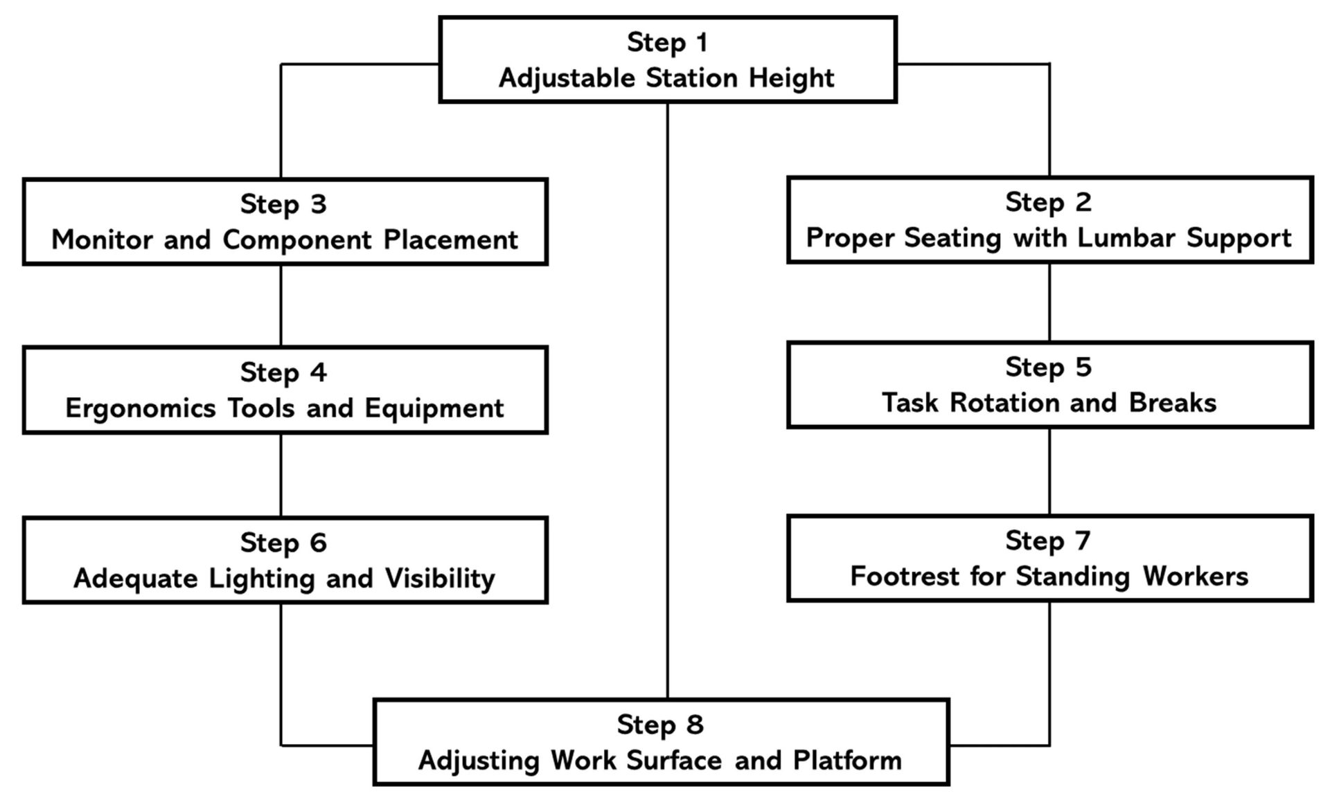

Flowchart outlining 8 ergonomic steps, from adjustable station height to work surface adjustment.
This chart lists the major ergonomic improvement steps we suggested. Source: University of Johannesburg
Design Improvement and Implementation
We made several suggestions for ergonomic improvements to address the high degrees of discomfort in the neck, lower back, and shoulder.
Our new workstation design incorporates several improvements aimed at reducing discomfort and preventing injuries. Adjustable work heights allow operators to position the work surface to suit their individual needs, minimizing bending and reaching. Some work surfaces are slanted to lessen bending and make it easier to reach components. In addition, the work surfaces that contact the body have ergonomic cushioning.
Seated workstations allow operators to keep their elbows at a 90-degree angle, while standing workstations are positioned at elbow height to reduce back and shoulder strain. Proper seating with adjustable lumbar support promotes a neutral spine position, preventing lower back discomfort. For standing tasks, anti-fatigue mats and footrests reduce pressure on the back and legs.
We also ensured that materials and screens were positioned at eye level, reducing neck strain. Tools were placed within easy reach to avoid unnecessary bending or stretching. Ergonomic tools with cushioned grips were introduced to reduce wrist strain, and adjustable tool holders bring tools into a neutral position. Tool racks and component trays are positioned 14 to 18 inches away from the user to minimize reaching.

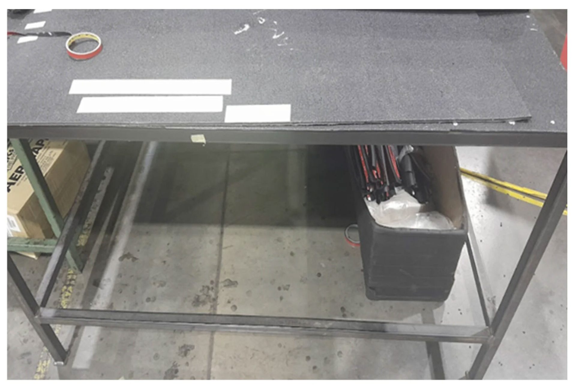

A grey workbench with white strips, tape, a metal frame below, and a black container on a concrete floor.
The original worktable was 550 millimeters in height and was not adjustable. That required operators to bend at a mild flexion angle of 45 degrees when assembling tailgates. Source: University of Johannesburg
Task rotation and regular breaks were implemented to reduce repetitive strain injuries. Workers alternate between tasks and take micro-breaks every 30 to 60 minutes. Adequate lighting ensures work areas are well-lit, reducing the need for awkward head positions. Finally, footrests and adjustable work surfaces ac-commodate varying worker heights, ensuring that all operators can work in a neutral, comfortable posture. These improvements promote better health, com-fort, and productivity.
The original worktable was 550 millimeters in height and was not adjustable. That required operators to bend at a mild flexion angle of 45 degrees when as-sembling tailgates.

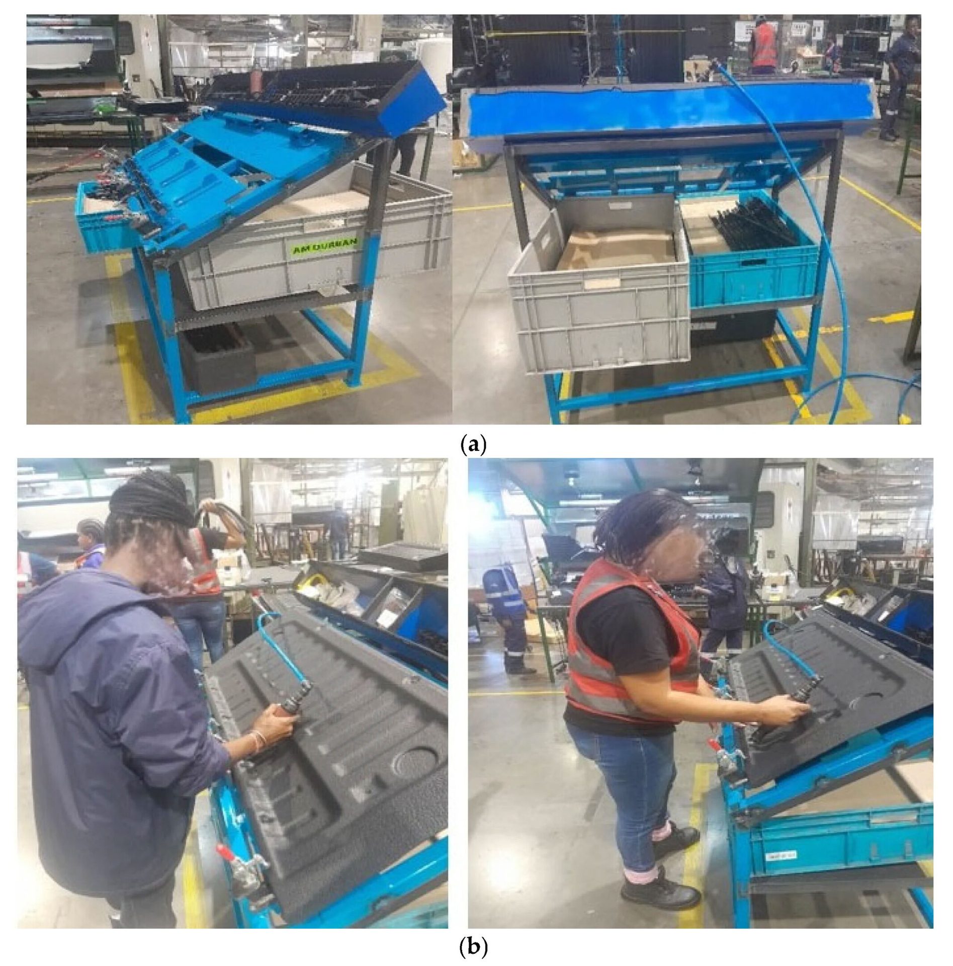

Our new workstations are adjustable to accommodate all employees assembling tailgates, eliminating excessive bending, as well as neck and shoulder strain. Our redesign also positions materials needed for tailgate assembly closer to the worker, minimizing movement and reducing manual material handling.
Factory assembly station: workers using a blue jig and tools to attach components to black panels.
After implementation, 95 percent of the workers revealed high improvement in comfort level, particularly in the upper back, neck, and lower back, working with the developed ergonomically sound workstation. It is expected that the changes will also enhance productivity, reduce absenteeism, and improve job satisfaction.
