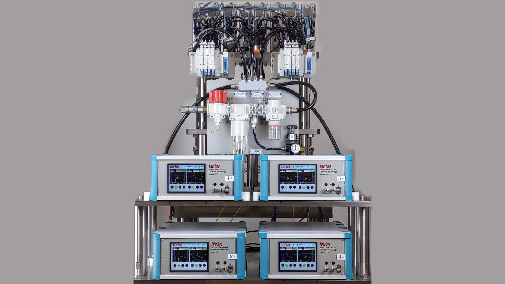

InterTech leak detection system with pneumatic controls and four MED73 units.
Sixteen InterTech test heads replaced 192 pressure decay test heads. Photo courtesy InterTech Development Co.

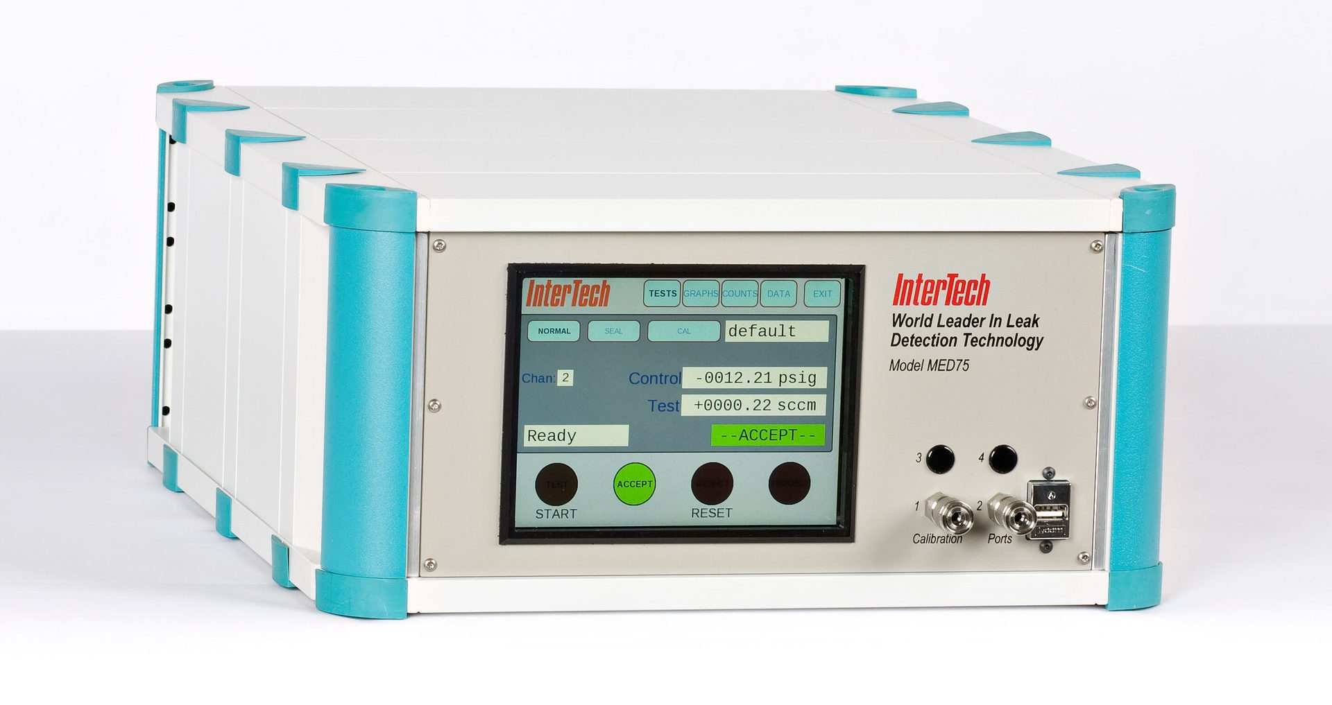

InterTech Model MED75 leak detection system, white and teal, with a screen, buttons, and ports.
This instrument can leak test 16 parts every 2.8 seconds or 150 parts per hour. Photo courtesy InterTech Development Co.
InterTech’s MicroScale leak test technology effectively eliminated the testing errors (both false positives and false negatives) inherent in the pressure testing methods that the company had previously used. Faster throughput was achieved by replacing inefficient test instruments with InterTech MED75 MicroScale leak testers, which feature dual, independent test channels.
The instruments can reliably find holes as small as 0.5 micron in diameter.
