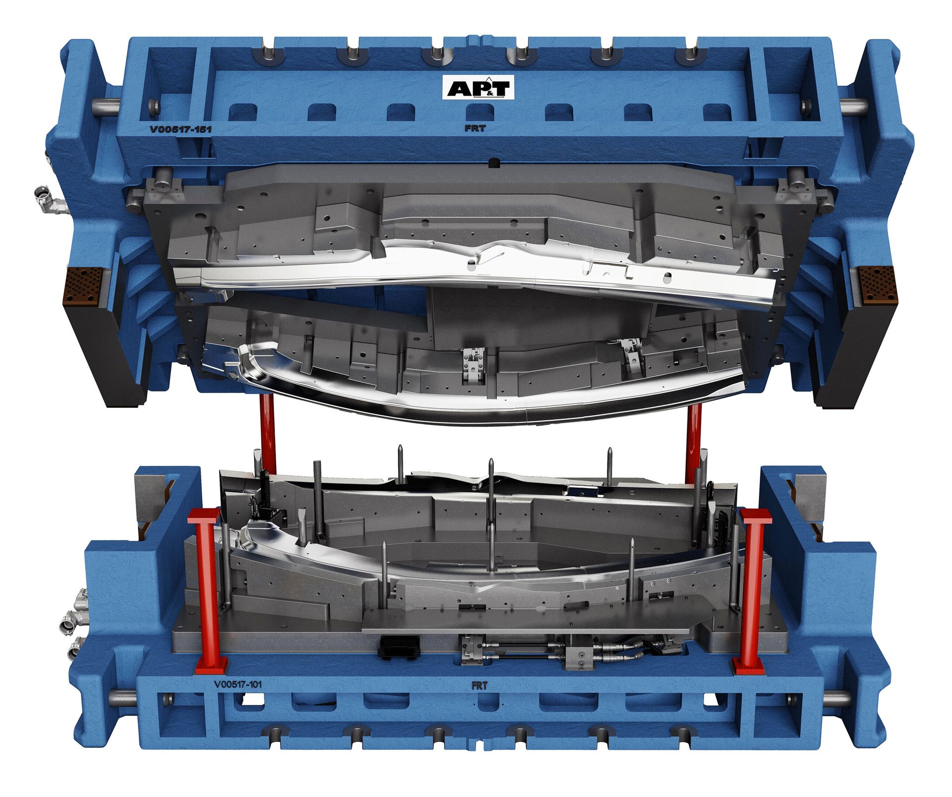

During press hardening, boron steel blanks are heated to a temperature as high as 930 F, formed and cooled in a carefully controlled process. During the process, the steel’s molecular structure is transformed into ultra high strength steel (UHSS). The finished part is three times more stable than the original material, and it becomes extremely strong in relation to its weight.
The method also enables the manufacture of complex part shapes with high dimensional stability and a great deal of repeat accuracy in a quick and cost-efficient manner.

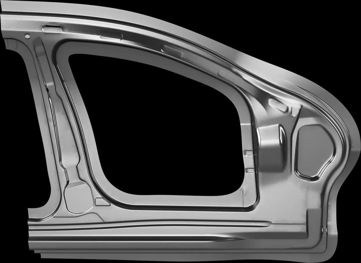

Typical press hardened parts include the A and B pillars, the front and rear side members, cross-members and door rings.

AP&T’s lines include all of the equipment to make press hardened parts, including presses, automation, tooling and furnace systems.

“The new line is primarily used to manufacture door rings for one of our larger American customers,” says Jeon Incheol, senior manager of the overseas sales team at Simwon Co Ltd. “To meet their needs, the technology has to run faultlessly, and we need to be able to produce at top speed. AP&T’s line has exceeded our high expectations. The output is between 15 and 20 percent higher than our other press hardening lines.”
