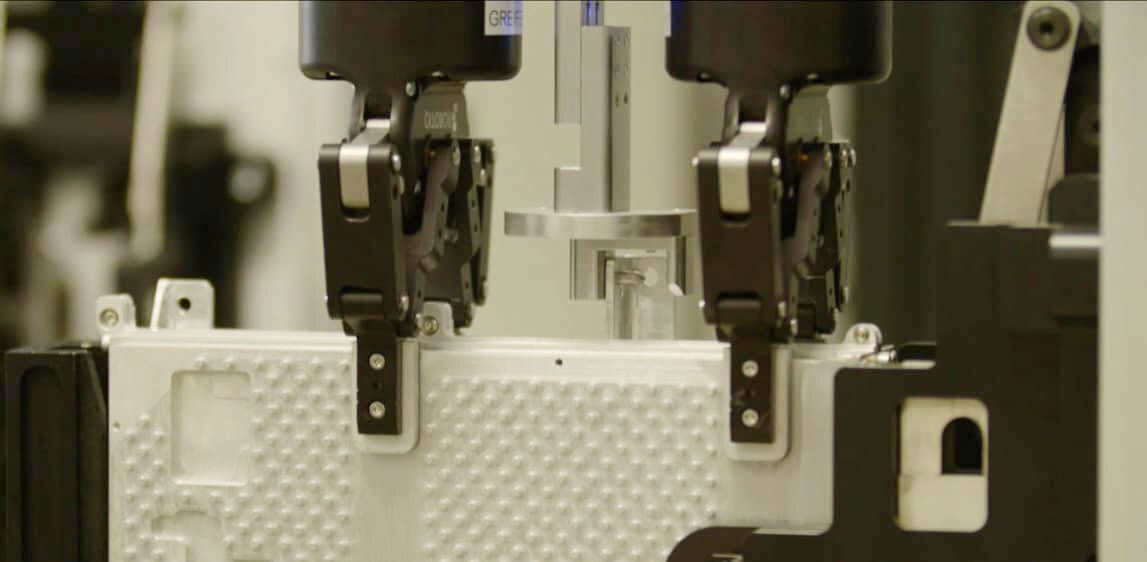

Gripping force is adjustable to avoid damaging the assembly’s aluminum housing and the electronics within. Photo courtesy Robotiq

“These computers are fragile, and they weigh 4 kilograms with an asymmetric center of gravity,” explains Marvin Plantius, CEO of KPI Engineering. “We were looking for equipment with adjustable force to avoid damaging the aluminum housing and electronics within. We also needed highly repeatable accuracy despite the 4-kilogram payload.”

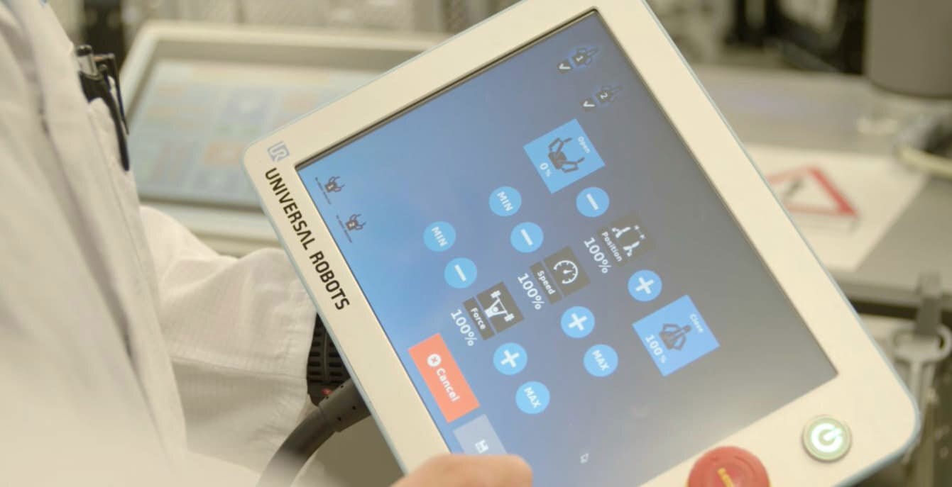

The gripper is programmed through the robot’s teach pendant. Photo courtesy Robotiq

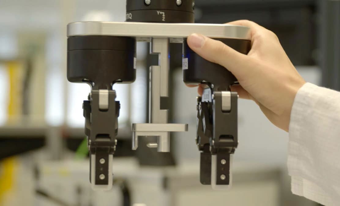

KPI chose a pair of Robotiq 2F-85 adaptive two-finger grippers and a FT 300 force-and-torque sensor to handle the computer case.
The 2F-85 is adaptable and versatile. Stroke, speed and force are programmable. Maximum stroke length is 85 millimeters, and it can produce a grip force of 20 to 235 newtons. Designed to pick up a range of objects, the device allows for both encompassing and pinch grips. Replaceable fingertips enable engineers to match the gripper to the part. The gripper can carry a maximum payload of 5 kilograms.
“We needed a very flexible gripper with which we could easily monitor force and the distance between two points,” says Plantius. “The 2F-85 was an obvious choice. The big advantage of the force-and-torque sensor is that you can record complex movements with the path-recording function. Force can be monitored for critical movements, such as when components contact the parts trays.”

Designed to pick up a range of objects, the gripper can perform both encompassing and pinch grips. Replaceable fingertips enable engineers to match the gripper to the part. Photo courtesy Robotiq
Complex Application, Easy Programming
The testing application is controlled by a human-machine interface, independent from the Universal Robots teach pendant. The robot first receives the signal to retrieve a computer with both grippers. Prior to inserting the computer into the tester, the robot takes it to a scanner, which reads a bar code.
Once this operation is done, the computer is placed in the testing unit. The pair of grippers ensures that the computer is placed in the tester in the exact same position every time. The robot then closes a lever, and the testing phase starts. After testing is complete, the robot unloads the computer, and the process repeats.
