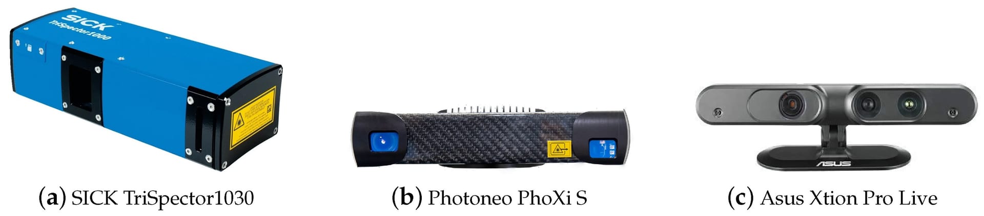

Given the importance of this technology to this application, we set out to compare several 3D vision systems to determine which one is best for automating fastening on an automotive assembly line.
Three different 3D vision sensors: SICK TriSpector1030, Photoneo PhoXi S, and Asus Xtion Pro Live.
The researchers evaluates three sensors: the Sick TriSpector1030 (laser line triangulation), the Photoneo PhoXi S (visible stripe pattern structured light) and the Asus Xtion Pro Live. Source: Institute for Systems and Computer Engineering, Technology and Science

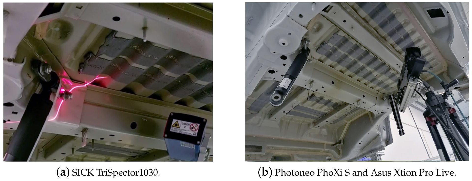

Specifically, we looked at the process of fastening rear axle dampers to the undercarriage of a van. The vans are transported from station to station on an overhead conveyor. When a van arrives at the workstation, an assembler picks an axle damper from a bin, goes underneath the vehicle, and installs it to the rear undercarriage, which has two attachment points.
Next, the assembler hand-starts two bolts at those points. Then, using a pair of fixtured electric tools, the assembler tightens both bolts at once. This process is performed for both the left and right rear wheels.
Ad for The Assembly & Quality Show on Oct 27-29, 2026 in Rosemont, IL. Experience assembly tech.
Since this task is repetitive and non-ergonomic, the automaker wanted to automate the process. Now, the assembler still installs the dampers, but a vision-guided robot tightens the bolts.

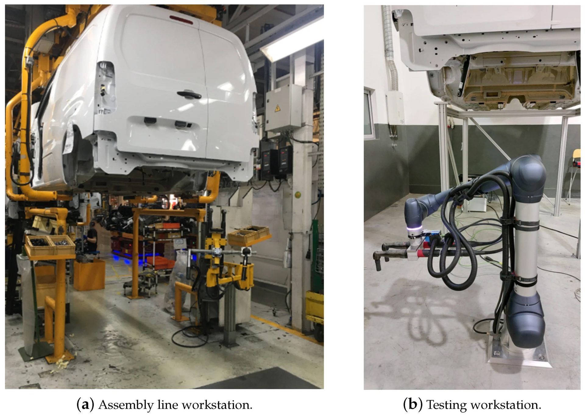

Since the position of the van at this workstation varies due to mechanical tolerances of the conveyor and the weight of the vehicle, the robot must perceive the position of the axle damper attachment structure to successfully perform the bolt-tightening operation. So, 3D vision is critical for this application.
In addition to comparing sensors, we assess the success of our robotic bolt-tightening system. Unlike other approaches, which depend solely on the vision system’s ability to find the bolts themselves, our system relies on the 3D perception of the structure of the vehicle in which the bolts were attached. This approach allows for unambiguous pose estimation in six degrees of freedom, as the vehicle’s structure has a surface with unique geometry and a higher number of points compared to the bolts.
Two industrial scenes: a white van body on an assembly line and a robotic arm testing a vehicle chassis.
These images show the workstations on the assembly line and the testing environment for fastening the two rear axle dampers. Source: Institute for Systems and Computer Engineering, Technology and Science

Vehicle undercarriage scanned by SICK TriSpector1030 (laser) and Photoneo PhoXi S / Asus Xtion Pro Live sensors.
These images show the 3D sensors in place for capturing measurements. Source: Institute for Systems and Computer Engineering, Technology and Science

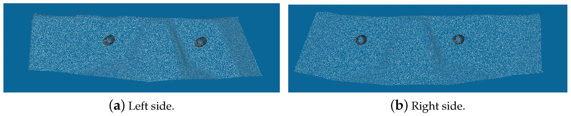

Two views of 3D point cloud models, each featuring two holes and a diagonal groove.
These images show the point clouds extracted from the van’s CAD file (without the axle damper) for each side of the van. Source: Institute for Systems and Computer Engineering, Technology and Science

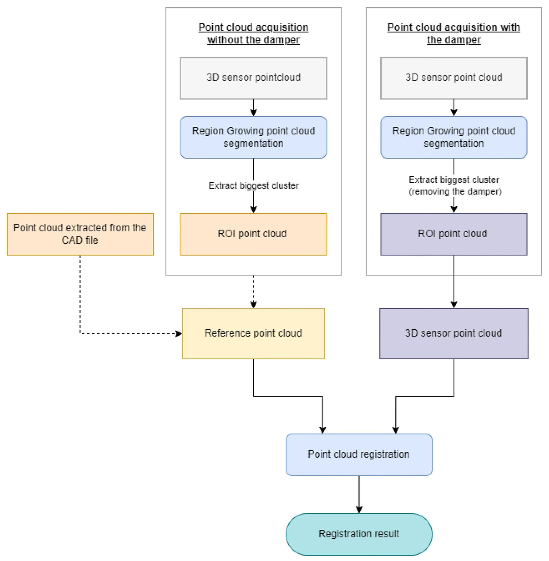

Flowchart showing point cloud acquisition without/with damper, CAD extraction, and registration.
This diagram shows the methodology the researchers used for comparing the sensors. Source: Institute for Systems and Computer Engineering, Technology and Science

With this in mind, we chose three sensors to evaluate: the Sick TriSpector1030 (laser line triangulation), the Photoneo PhoXi S (visible stripe pattern structured light) and the Asus Xtion Pro Live (infrared speckle pattern structured light).
The Sick sensor is the only one with embedded processing. It is programmed using SOPAS Engineering Tool software. The Photoneo and Asus sensors need an external PC to process their data. To compare the sensors fairly, then, we did not use the embedded capabilities of the Sick sensor, and an external PC was used to process the 3D data from all three sensors.

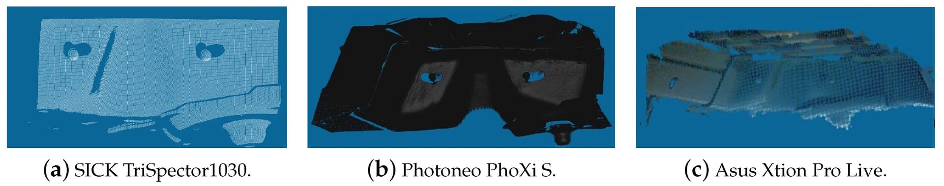

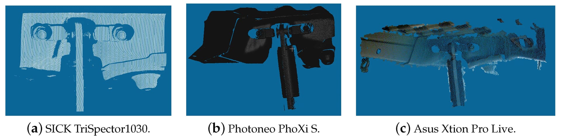

To compare the performance of the three sensors, point clouds of the axle damper attachment structure with and without the axle damper were acquired in a testing environment similar to the real assembly line—namely, with a real van and axle damper samples that could be manually placed and removed.
Three point cloud scans of an object, generated by SICK TriSpector1030, Photoneo PhoXi S, and Asus Xtion Pro Live sensors, illustrating different capture methods.
These images show the point clouds of the axle damper attachment structure without the damper. Source: Institute for Systems and Computer Engineering, Technology and Science

Two reference point clouds were used as the ground truth: one extracted from the scans without the axle dampers and another from the CAD model of the van.

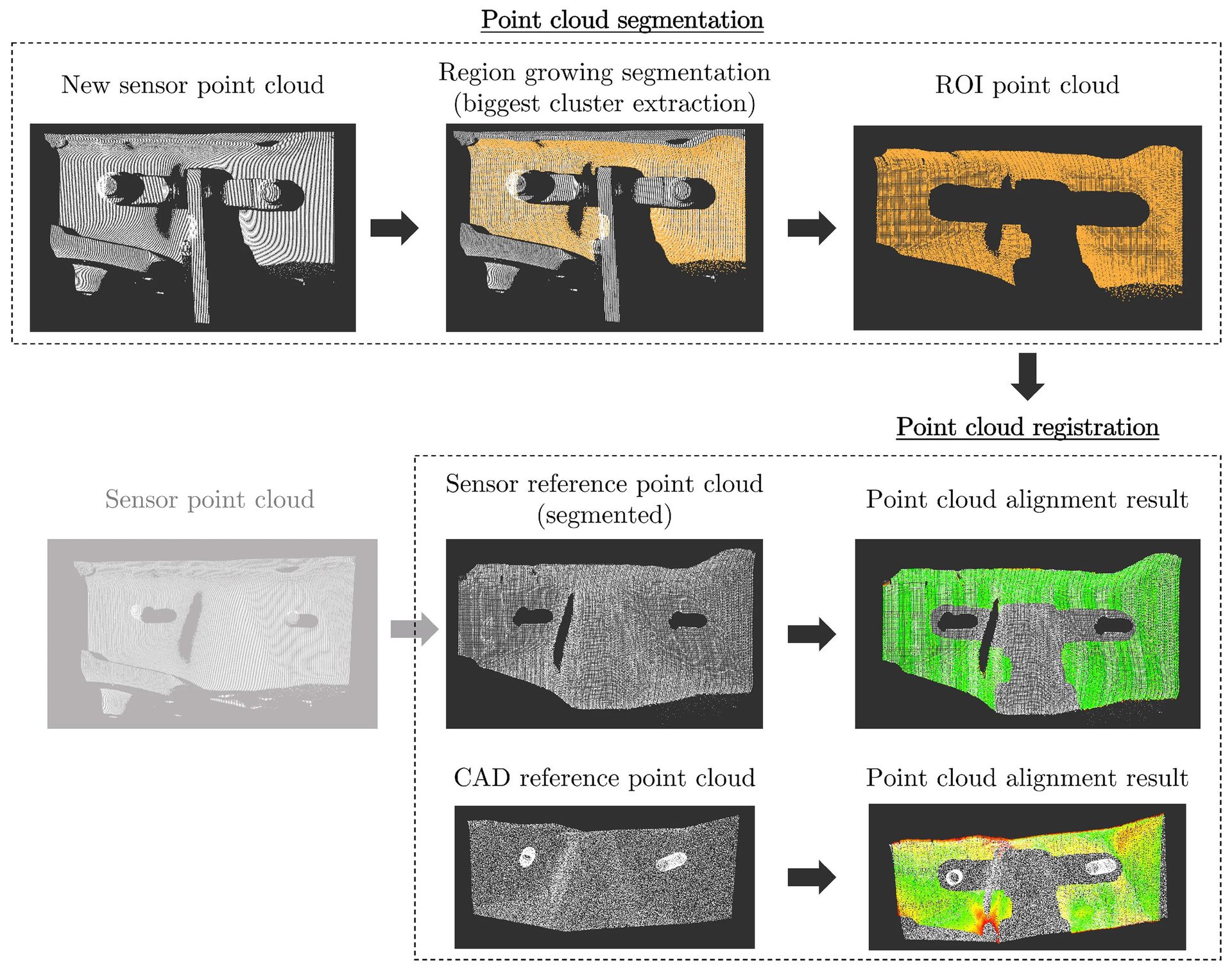

To create the reference point cloud from the 3D sensors scans, the point cloud without the axle dampers was filtered and segmented with the following steps:
    * Scan the van without the axle damper
    * Crop the point cloud if necessary (only applicable for the Asus Xtion Pro Live sensor due to its higher scan volume).
    * Segment the point cloud into clusters using the region growing segmentation algorithm.
Extract the region of interest where the axle damper will be placed (considering the acquired point clouds, this corresponds to the biggest cluster).
The region-growing segmentation algorithm starts by sorting the points by their curvature. It then selects as the first seed the point with the lowest curvature. Then, it keeps expanding the current cluster seeds by adding neighboring points that have an angle between the current seed and the neighboring point below a given threshold. After no more points can be added to the current cluster, a new cluster is initialized with a seed point that has the lowest curvature from the points that do not yet belong to a cluster. The algorithm for growing and creating new clusters keeps repeating until all the points are associated with a labeled cluster.

This segmentation algorithm was selected because the van support structure has a locally smooth surface with transition zones to the axle damper surfaces with large curvature differences. Moreover, the support structure has a surface area that is much higher compared with the axle damper, allowing the segmentation selector to pick the cluster with the largest number of points.
After this procedure was executed for all the reference point clouds without the axle damper, the point clouds acquired with the axle damper were filtered by following the same steps.
Then, the registration of both point clouds was performed with different voxel grids (1 and 5 millimeters). The accuracy of the point cloud registration using the iterative closest point (ICP) algorithm was measured by computing the root mean square error (RMSE), which was obtained by computing the Euclidean distance between corresponding points from the scan and reference point clouds. The RMSE was calculated for each registration, in which points with a corresponding reference point distance lower than a given threshold were marked as inliers.
The ICP algorithm aligns the sensor data with the reference point cloud by iteratively computing the six-degree-of-freedom matrix transformation that minimizes the RMSE of a given set of correspondences. For each iteration, every point in the sensor data is matched with the respective closest point in the reference point cloud. Points that have a correspondence distance higher than a given threshold are discarded from the list of correspondences to allow the algorithm to tolerate outliers.
Then, the singular value decomposition (SVD) method is used to compute the six-degree-of-freedom transformation that minimizes the RMSE of the correspondence distances. The algorithm stops when the RMSE is below a given threshold or when the computed matrix has converged and stabilized.
Flowchart illustrating point cloud segmentation into a region of interest, followed by registration and alignment.
These images show the process of segmenting and registering the point clouds. Source: Institute for Systems and Computer Engineering, Technology and Science

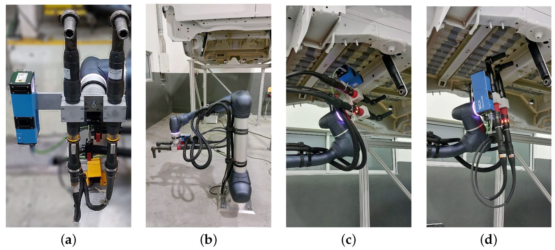

Four views of a robotic arm equipped with sensors and tools inspecting the underbody of a car chassis.
Our workstation consists of a six-axis cobot with a reach of 1,700 millimeters and a maximum payload of 20 kilograms. Two screwdrivers are attached to the cobot’s end-efffector. Source: Institute for Systems and Computer Engineering, Technology and Science

Given the test results, we chose the Sick sensor for our robotic fastening station. Our six-axis cobot had a reach of 1,700 millimeters and a maximum payload of 20 kilograms. Two screwdrivers were attached to the cobot’s end-efffector. The robot base was centered in relation to the left and right axle damper locations.
The process works as follows:
    • The robot moves the 3D sensor to scan the van without the axle damper to create a reference point cloud.
    • The pose of the attachment structure with respect to the robot is determined.
    • The assembler places the axle dampers in position on the van.
    • The robot moves the sensor to capture a new scan of the van with the axle damper in place.
    • The new point cloud is aligned with the reference point cloud using the ICP algorithm.
    • The point cloud alignment is validated to ensure that it has a minimum percentage of overlap between the reference point cloud and the new scan.
    • The transformation matrix between the robot base and the axle damper attachment structure is computed.
    • The robot tightens the bolts.
    • The total cycle time is 160 seconds.
