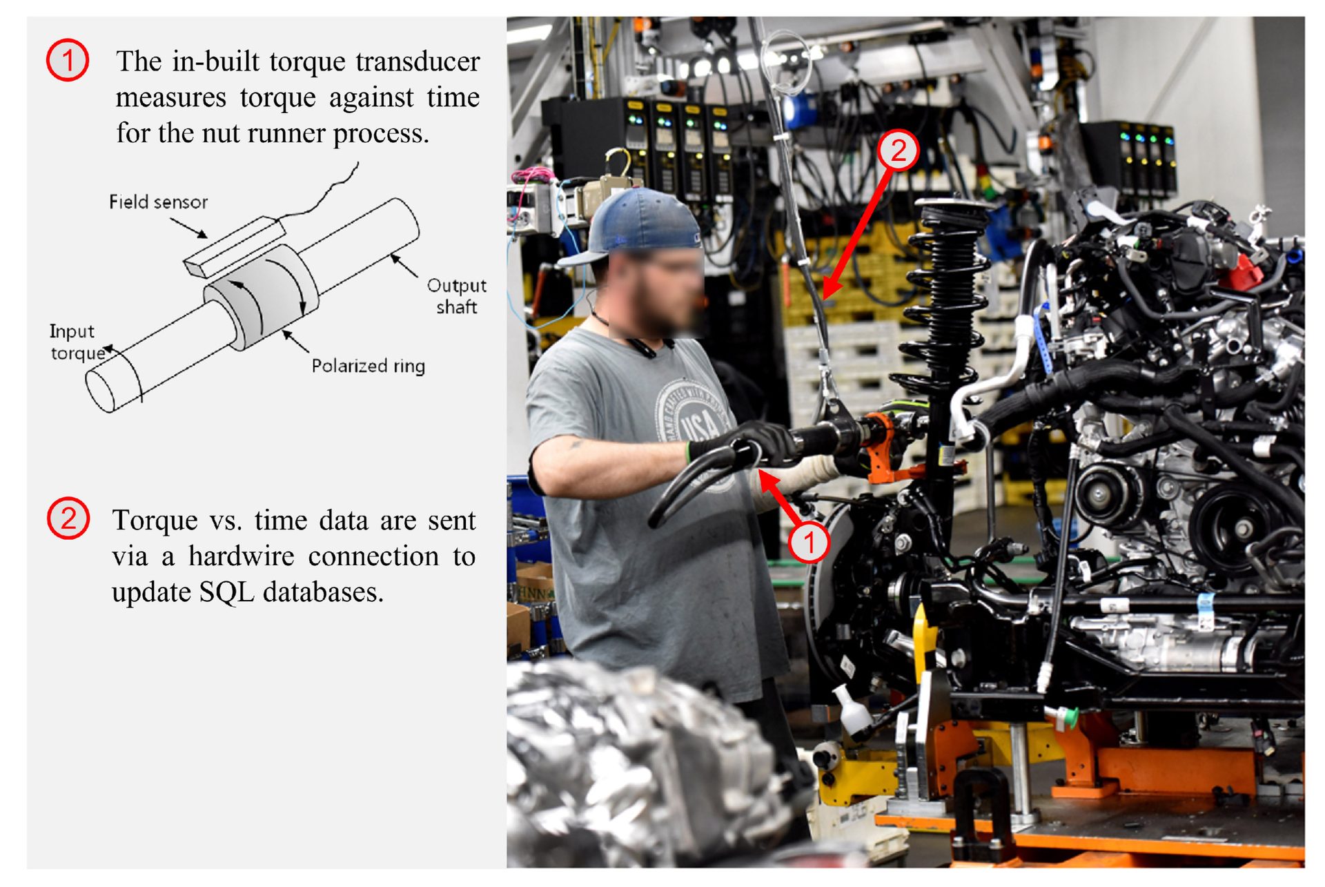

An assembler uses a DC electric nutrunner to tighten a bolt on an engine. Photo courtesy Ford Motor Co.
To that end, we sought to develop machine learning algorithms that could automatically detect errors when installing threaded fasteners with DC electric nutrunners.
At Ford, we are already using machine learning to monitor our manufacturing processes. Specifically, we use a single unsupervised algorithm to detect anomalies in various assembly and test processes. We use principal component analysis (PCA) to reduce the dimensionality of the time series data. We then perform a cluster analysis using density-based spatial clustering (DBSCAN) under the assumption that any noise points are anomalies.
This approach is successful with a range of end-of-line tests, outperforming the traditional static limit approach. However, it is not effective at identifying anomalies in fastening processes.
Detecting anomalies when tightening threaded fasteners is challenging. Yes, a transducer in the nutrunner can measure torque and angle over time, and that data can be analyzed to detect process anomalies. The challenge lies in the variability of that data.

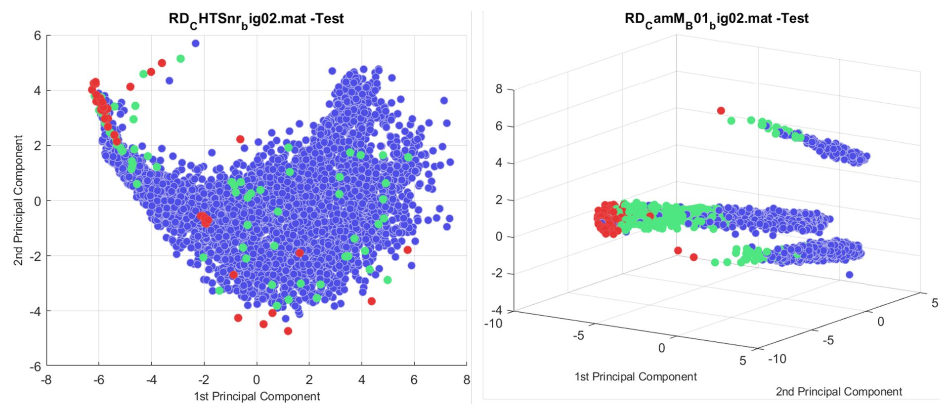

These graphs show the labeled plots of the first two principal components for datasets 1 and 2. These plots show that, when applying the PCA transform on nutrunner data, not all noise points are anomalies, anomalies can form tight clusters, and not all are outliers. Photo courtesy Ford Motor Co.

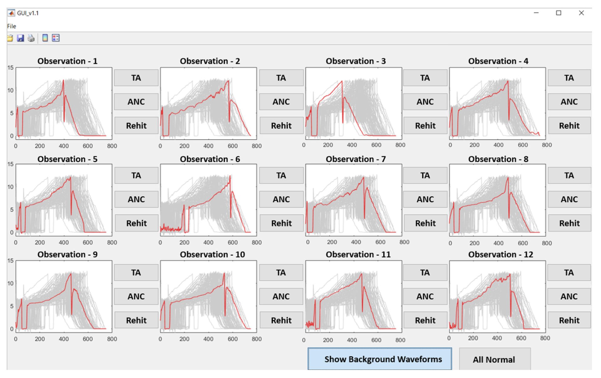

The task of labeling nutrunner data was therefore our first major hurdle. Even fully unsupervised methods require high-quality datasets to validate accuracy. In fault detection applications, training datasets will likely be highly imbalanced, since fault instances are rare. Therefore, large amounts of data must be reviewed by process experts to gather sufficient data to validate the model.
To create our dataset, we gave three fastening experts data from 5,000 run-downs to label. We developed a dashboard to speed up the labeling process. The dashboard presented each expert with a set of 12 run-down graphs to label. Given that anomalies were presumed to be rare, the experts were informed that all the data were examples of normal operating conditions.
If the experts saw any instances that could be considered anomalous, they were asked to label them as follows:
    • True anomaly. True anomalies are instances where either a known process anomaly has occurred that has compromised part quality, or an unknown anomaly has occurred that requires further inspection before the assembly is released.
    • ANC. An ANC is defined as an anomalous observation for which no action is needed. This may be because the anomaly can be explained by a known process error that is unlikely to have compromised quality.
    • Re-hit. A re-hit is an instance where no data were recorded and the amplitude of the time series remains constant at 0.
If none of the 12 examples fell within one of these categories, a refresh button was used to label all observations as “normal,” and the display was refreshed with a new batch of 12 images.
This approach proved to be fast, since less than 1 percent of the run-downs included true anomalies. Using this system, our experts were able to label data at a rate of approximately 1,000 observations every 30 minutes.

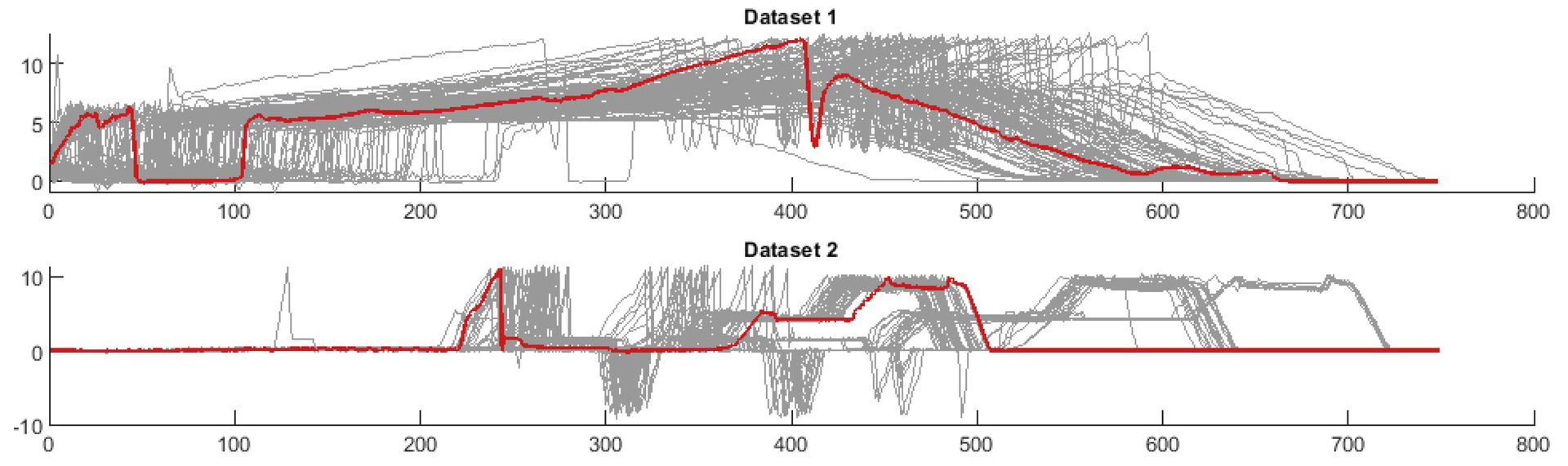

Ultimately, we created two testing datasets: dataset 1 and dataset 2. Dataset 1 is a handheld nutrunner with high variability. Dataset 2 is an automated process in which a staging problem can be clearly observed.

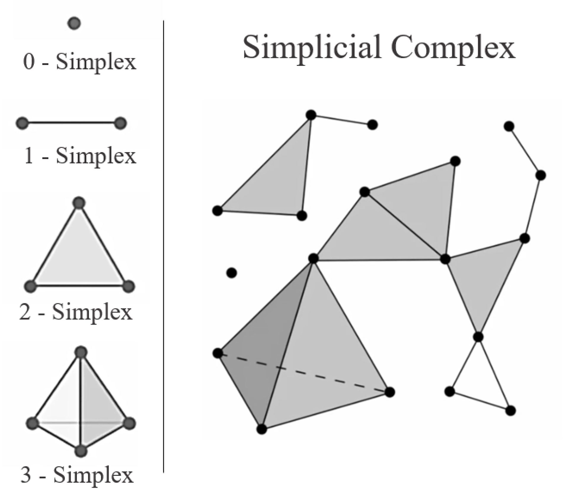

Simplices can be combined into a simplicial complex to describe a multi-dimensional feature space. Photo courtesy Ford Motor Co.

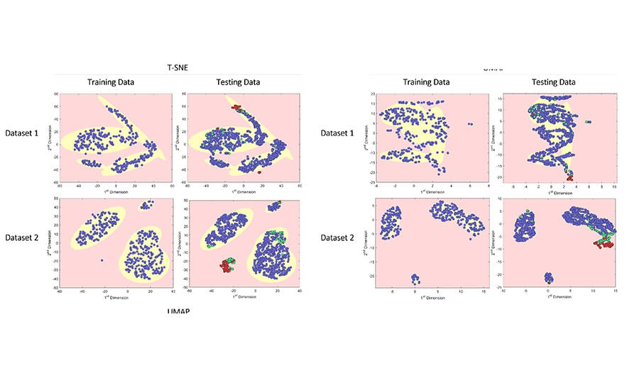

We also compared t-SNE and UMAP with PCA at clustering the data in 2D before applying the semi-supervised GMM. T-SNE and UMAP are neighbor graph approaches that determine the similarity between the data points before projecting the data onto the lower dimensional space.
UMAP is by far the most complex approach. At a high level, UMAP applies manifold approximation together with local set representations to map the data onto lower dimensional space. These high-dimensional set representations, known as simplicial sets, describe the high-dimensional feature space by combining multiple simplices defined by the data points.
Because t-SNE is a probabilistic approach, and both t-SNE and UMAP use stochastic processes, we had to combine the training and testing data and perform dimensionality reduction on both datasets to ensure they were mapped onto the same lower dimensional feature space. The 2D outputs of the dimensionality reduction are then split back into the training and testing sets before applying GMM for semi-supervised clustering.
Our GMM was then trained in a semi-supervised manner, using 400 normal training data points and the number of Gaussian components.
Because both t-SNE and UMAP use stochastic processes, the researchers combined the training and testing data and performed dimensionality reduction on both datasets to ensure they are mapped onto the same lower dimensional feature space. This graph shows how t-SNE was applied to the training and testing nutrunner data. Photo courtesy Ford Motor Co.

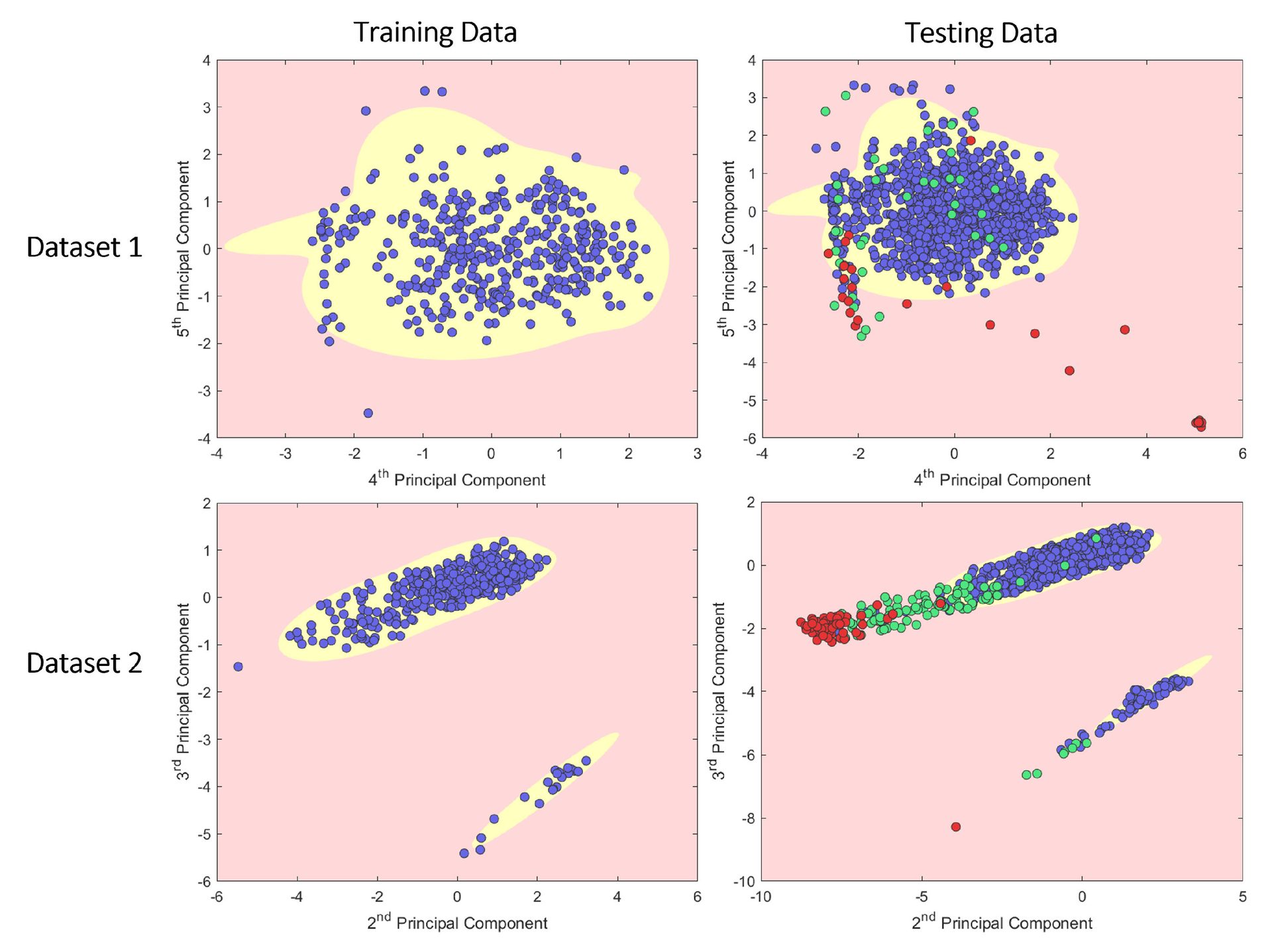

The researchers applied a GMM to their data. These graphs show a plot of datasets 1 and 2 with the outlier thresholds visualized. Photo courtesy Ford Motor Co.
The results of our semi-supervised GMM algorithm largely depended on the dimensionality reduction approach used to prepare the data. For Dataset 1a, where ANCs are considered true anomalies, the PCA-GMM performs the best, achieving F-scores of 0.55 compared to 0.25 and 0.27 for t-SNE-GMM and UMAP-GMM respectively. The t-SNE and UMAP approaches are less desirable in comparison, with t-SNE returning a low recall, while UMAP returns a low precision. However, all methods outperform the current PCA and DBSCAN used for anomaly detection.
When considering Dataset 1b, where ANCs are considered normal, the PCA-GMM method sees a drop in true positive rates and false negative rates. The t-SNE approach is the only method for which the F-score increases when ANCs are treated as normal data. This aligns with the findings during model development, where t-SNE was found to be useful in identifying true anomalies contaminating the normal training data. However, the method was not as good at distinguishing between ANC and normal data.
The UMAP-GMM achieves the highest recall of all methods on Dataset 1. However, the very low precision makes the approach undesirable in practice, since it would result in considerable added work for test engineers to review all the false positives.
For Dataset 2a, the PCA-GMM performs the best of all methods, achieving the highest recall and second-highest precision. Furthermore, when considering Dataset 2b, this method identifies 100 percent of the true anomalies. The t-SNE-GMM also performs well on Dataset 2, with similar results to the PCA-GMM method. The UMAP-GMM is once again the least-best method, due to high false positive rates. However, it still achieves a higher F-score than the original PCA-DBSCAN approach.
