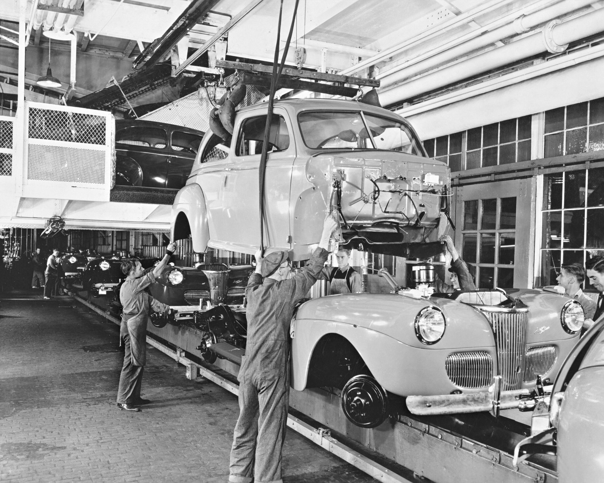

“Car chassis flying through the air, like Peter Pan’s enchanted galleon, vehicles moving seamlessly on tracks as various operations were undertaken on them, and the sensational walk-throughs of the factory floor and the exhibits on American industry and history; these were the models of automation that the Ford factory offered to Walt Disney in 1948,” says Betancourt.
“Unlike the earlier assembly line that required human intervention along every stage of movement, Detroit automation sought the streamlining of this process,” Betancourt points out. “This would find its matured manifestation in the Cleveland Engine Plant that would open in 1952 and become a symbol of automation writ large.”

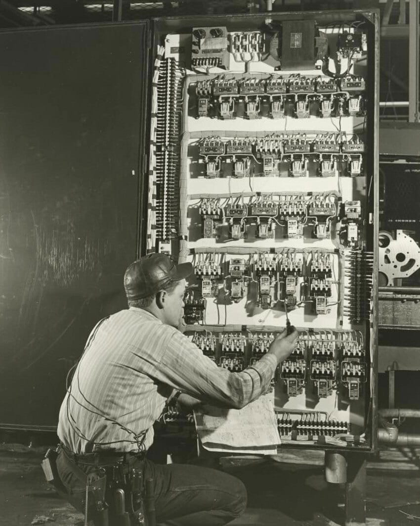

“What made the Cleveland Engine Plant so interesting to contemporaries was the way in which Ford had linked these transfer machines together by automatic conveying equipment such that little human assistance was necessary for conveying, loading or unloading work in process,” says David Hounshell, Ph.D., professor emeritus at Carnegie Mellon University and the author of From the American System to Mass Production, 1800-1932. “Handling devices allowed parallel or multiple machining tasks to be fed automatically, thus achieving balance in machining capabilities.
“All these automatic conveyance devices were controlled by a hard-wired control panel of telephone-type relays—an electromechanical ‘brain,’” explains Hounshell. “The system included a series of interlocks to ensure correct conveyance and feeding of parallel lines.
“Assembly operations at the plant also relied extensively upon automated conveyance systems, which with their power-and-free capability allowed for greater flexibility than the automated equipment in the machining areas,” Hounshell points out.

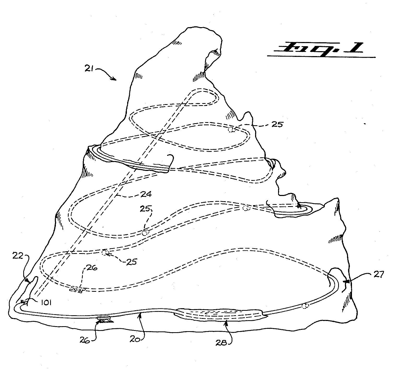

When Disneyland opened in 1955, one of its original rides in the Fantasyland section was Peter Pan’s Flight, based on a Disney animated film that was released two years earlier. Today, it remains one of the only attractions in the park that has not changed its location, despite updates in 1983 and 2015.
In the popular “dark ride” (an amusement park industry term for a track-based ride-through attraction in a dark building), guests board a pirate galleon and take a magical journey over London and Never Land. The 7-foot-long fiberglass ships are lifted by their masts and carried along a single rail hung from the ceiling, which the sails of the ships conveniently conceal from guests.
The Peter Pan ride makes use of forced perspective more than any other attraction at Disneyland. Although people feel like they are flying miles above various London landmarks, they sail at a maximum height of 17 feet.
The ships are suspended from an overhead monorail system that was originally developed for use in factories and foundries. When developing the ride in the early 1950s, Disney engineers turned to the Cleveland Tramrail division of the Cleveland Crane & Engineering Co. (a firm that was eventually acquired by Gorbel in 2002).
Riders become Peter Pan and share his adventures as he outwits Captain Hook and his pirates. The ride is enhanced by various special effects, such as a snapping crocodile, that are triggered by the vehicles’ movement.
Adapting an overhead monorail was an ingenious idea, because the arch beam conveyor could easily twist, turn, elevate and descend while providing a safe, smooth ride that lasted several minutes. Each vehicle was powered by a 1-hp electric motor attached to the rail.
The final design used wide-radius curves and modest ups and downs so that the trip would make people feel like they were sailing through the clouds. Seven galleons moved along a 486-foot-long track at a speed of 4 feet per second.
When Disneyland opened, the ride received rave reviews from people who had never experienced anything like it.

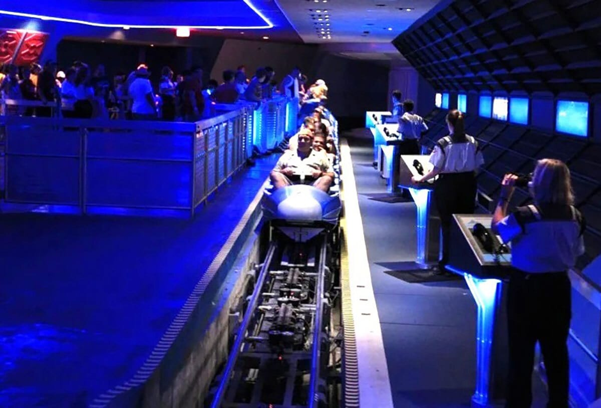

PLCs were first used in a theme park for the Space Mountain attraction at Disneyland. The roller coaster ride debuted in Tomorrowland in 1977. Disney imagineers eventually adopted the technology for the Matterhorn Bobsleds the following year and for the Big Thunder Mountain Railroad in 1979.
In the Adventure Thru Inner Space ride at Disneyland, Omnimover vehicles appeared to pass through a giant microscope. Photo courtesy Walt Disney Archives
“Willis Allen, an electrical engineer, had come across the automation revolution of PLCs and immediately sough to adopt it [at] Disneyland,” says Betancourt. “Allen adopted the original version of the PLC introduced by Allen-Bradley, known as a Bulletin 1774 PLC, whose patent had just been granted in 1976. Up to this point, the PLC had only been used in manufacturing. Allen’s early adoption of the PLC into the theme park has led some of his colleagues to call him the ‘father of modern ride control systems.’
“The original Allen-Bradley PLC was all hardwired, rather than being microprocessor based, which made it extremely reliable and fast,” explains Betancourt. “In Disneyland’s 1977 Space Mountain, the PLC was paired with a Data General Nova computer, whose primary task was to communicate ride conditions to the operators. With this new system, Willis Allen was able to replace the extensive racks of relays with a single PLC.
“Given the theming of Space Mountain, the attraction was uniquely able to represent the systems that controlled it in a manner that had never been fully possible at Disneyland,” Betancourt points out. “While the Cleveland Tramrail monorail might have mesmerized guests with its technological workings and the unique sensory experience it offered, the overhead monorail’s industrial realities could not be readily given representation for audiences in the context of Peter Pan’s story.
“This all changed with Space Mountain’s deployment of a ‘computer’ for its rocket-ship ride through the darkness of space,” notes Betancourt. “While Disneyland had largely glossed over their ride control systems on previous endeavors, internal and external publications highlighted Space Mountain’s control systems.
“The PLC allowed for a host of new safety concerns to be incorporated into the ride control system’s architecture that had been too complex for the old relay systems alone,” says Betancourt. “Now, vehicles could not only be spaced in terms of distance, but also by timing. A host of new safety precautions were incorporated into Space Mountain’s programming given the affordances of the PLC.”
Actuators, controllers, relays and sensors developed for use in factories enable Space Mountain and other rides at Disney theme parks to operate safely and reliably. Photo courtesy Walt Disney World Resort

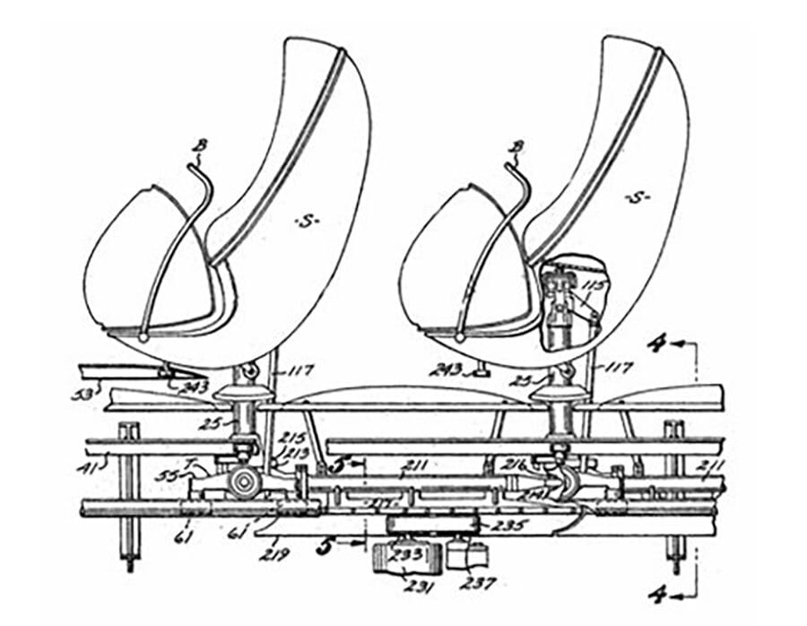

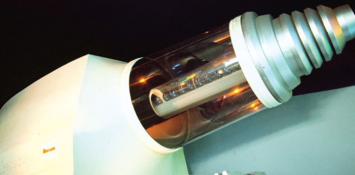

When Disneyland added a new attraction in 1967 called Adventure Thru Inner Space, Disney imagineers created the Omnimover system to address both safety and narrative. They borrowed ideas pioneered by the GM exhibits to enable people to be immersed in the story being told in front of their eyes. It allowed guests to be involved and present in the three-dimensional space unfolding around, making them become part of the story.
The patented Omnimover ride system provided high capacity through continuous loading and the ability to direct peoples’ attention to specific parts of a show scene, while providing an experience that came across as personal.
Adventure Thru Inner Space, which operated in Tomorrowland until 1985, was sponsored by the Monsanto Chemical Co. As part of a unique sensory experience, guests were transported in vehicles that were dubbed “atomobiles.”
Disney engineers used visual effects to magically “shrink” people to the size of an atom as they passed through a giant 37-foot--long microscope. Guests in the loading area saw full-sized atomobiles entering the base of the microscope. At the other end, angled high above, they witnessed a continuous line of miniaturized atomobiles moving through a transparent glass enclosure. The effect provided a simple visual illusion that people in the vehicles were being shrunk inside the microscope.
The Omnimover allowed Disney imagineers to “choreograph” a ride for the first time. Each automobile could pivot up to 180 degrees in either direction during the six-minute ride along a 682-foot loop of track, enabling visual surprises to be created as part of the storytelling process.
The Omnimover was revolutionary “because all the usual requirements for safety and control were eliminated by providing an endless chain of vehicles, which automatically opened and closed at loading and unloading, all moving at a constant speed throughout,” says Betancourt. “Here, a collision between two vehicles was physically impossible, because they were all hitched together in a daisy chain.
“These seats would ride under the floor on a tubular steel track on sets of load and guide wheels, just as on the Matterhorn Bobsleds,” explains Betancourt. “And they would be propelled by long fins protruding from the bottom of the arrangement at set distances, which would be pinched by a drive-motor-powered belt. This would translate the horizontal platen at the bottom of the vehicle onto a vertical ‘fin’ to advance the entire system forward at once.
“As the guest was moved along the ride, they would be directed at certain scenes and moments in the narrative,” Betancourt points out. “Similarly, with their scalloped, shelled form, which wrapped around the viewer’s periphery, the Omnimover was able to carefully curate one’s views across the ride. Here, Disney best combined the filmic gaze of the movies with the experience of the amusement park.
