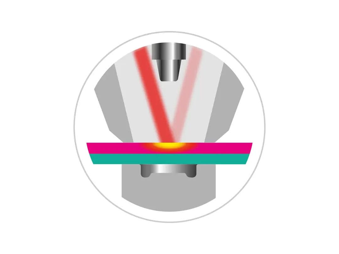

Prior to clinching, a laser applies targeted heat to the materials, significantly increasing their formability. Photo courtesy Tox Pressotechnik

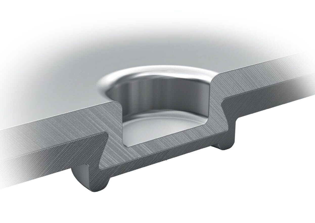

In clinching, a punch and die are used to plastically form a mechanical interlock between metal sheets. The technique produces a round, button-type connection between two to four layers of sheet metal. The process can join metal sheets of different thicknesses or materials, and it will not damage anticorrosive coatings on the metal. The minimum thickness for any one sheet in the assembly is 0.1 millimeter, and the entire stack can be up to 12 millimeters thick.
The tools consist of a punch and a die. The punch forces the layers of sheet metal into the die cavity. The pressure exerted by the press forces the punch-side metal to spread outwards within the die-side metal.

That is the concept behind the new Theta clinching process from Tox Pressotechnik. Prior to clinching, a laser applies targeted heat to the materials, significantly increasing their formability. This creates a reliable mechanical connection even with materials that are difficult or impossible to clinch under normal conditions, including high-strength and ultra-high strength steels, low-ductility die-cast aluminum alloys, and aluminum sheets.
Targeted heating immediately before clinching increases the local ductility of the materials so that even high-strength alloys can be joined reliably without pre-punching or cutting. Clinching with a cutting component can reduce the material’s fatigue strength due to notching, susceptibility to corrosion at the cut edges, and a nonhomogeneous joint quality.

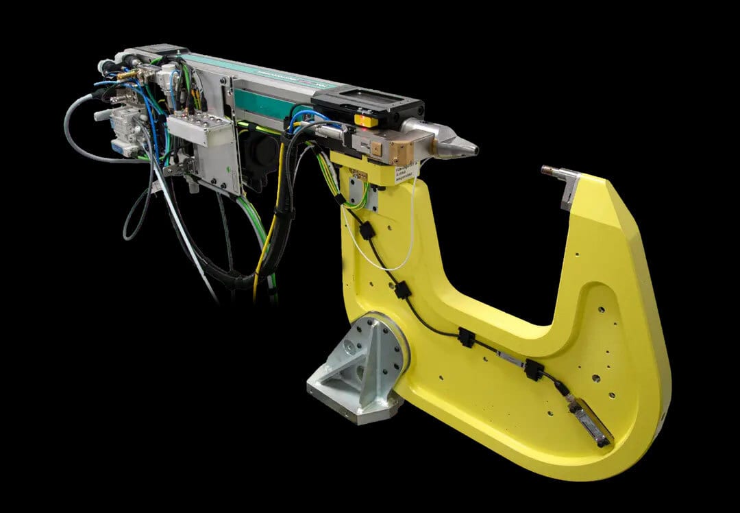

The Theta system consists of a standard Tox C-frame clinching press with a nominal pressing force of 80 kilonewtons. The laser is integrated with the press. Photo courtesy Tox Pressotechnik
The process has four steps. First, a focused laser beam heats the joining zone in a targeted manner. This thermal pre-treatment improves the formability of the material. Next, the clinching punch is applied immediately after heating. Due to the reduced flow resistance, the material begins to deform plastically, a precise transition from heating to forming without any loss of time.
The punch hits the prepared materials but does not pierce them. Instead, it is pressed into the die, compressing and deforming the materials without cutting them. The now-formable material flows under pressure into the die, creating a mechanical interlock with even load distribution. The result is a durable, corrosion-resistant joint.
The system consists of a standard Tox C-frame clinching press, or tong, with a nominal pressing force of 80 kilonewtons. The use of standard C frames keeps the system weight low and reduces side loads on the tool. A 2-kilowatt fiber laser with a wavelength of 1,070 nanometers is integrated into the press. The system is controlled centrally via the Tox MultiControl.
The system can be used with standard clinching tools for applications with a combined material thickness of up to 10 millimeters.
